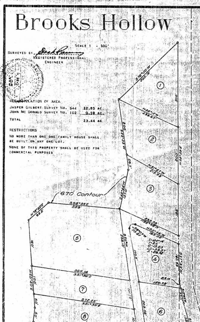

This is one of the more interesting problems I've dealt with. The basic situation was that a tract of land on Lake Travis, a flood control lake with a highly variable level, was subdivided into lots in August, 1950 according to a plat known as "BROOKS HOLLOW" prepared by a civil engineer named Doak Rainey. At the time that the plat was executed during a prolonged period of drought, the average level of the lake was reported by the Lower Colorado River Authority to have been 638 MSL, more than 43 ft. below the anticipated normal operating level and approximately 32 ft. below the lowest point on the ground surface along the lakeward boundary of the subdivision.
The land subdivided consisted of four certain tracts, the largest of which, and the one that actually fronted on Lake Travis, was a 15.15 acre tract that was bounded on its lakeward side by "a contour which is 670 feet above Mean Sea Level as established from U.S. Geological Survey Benchmarks" along which the deed also recited courses and distances following the meanders of said contour. The normal operating level of Lake Travis is nominally 681 feet, so when the lake is full, the boundary of the 15.15 acre tract would be 11 feet below it.
The significance of the 670 ft. contour was that in 1938 the subdivider's predecessor in title, a widow named Susan Clifton, had conveyed a inundation easement to the L.C.R.A. over that portion of a certain 180.5 acre tract "not exceeding 670 feet above mean sea level as determined from the United States Geological Survey benchmarks". A later owner of the 180.5 acres subject to the inundation easement had conveyed a certain 15.15 acre part of the 180.5 acres lying above the 670 ft. contour.
So, in 1950 Engineer Rainey evidently made a office plot of the four tracts owned by the subdivider using the the descriptions contained in the various deeds of record, attempting to piece them together, and drawing a scheme of subdivision using the results of his office plot. The subdivision boundary labeled "670' Contour" was clearly drawn from the courses and distances along the 670' contour as set forth in the 1938 deed to L.C.R.A. and repeated in the later deed of the 15.15 acre part above the 67 ft. contour.

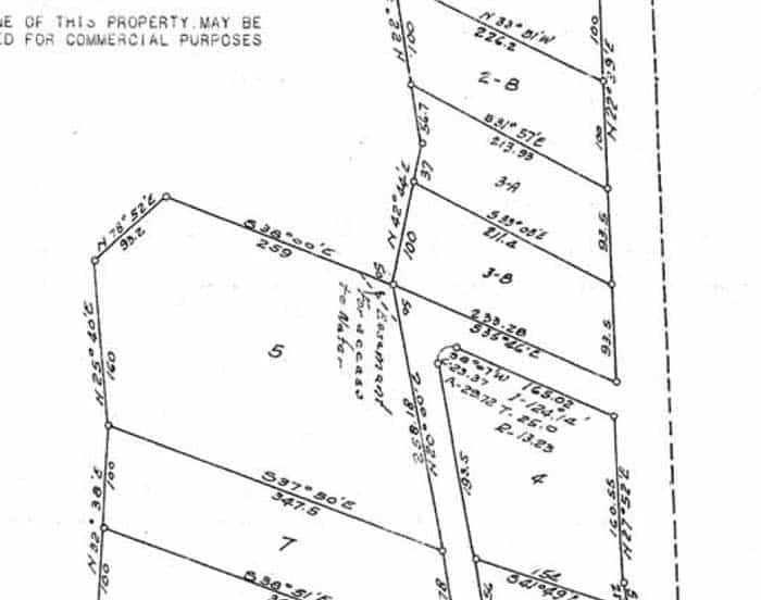

Note that Lots 3 and 5 touch at exactly one point, their common corner, as shown upon the 1950 plat.

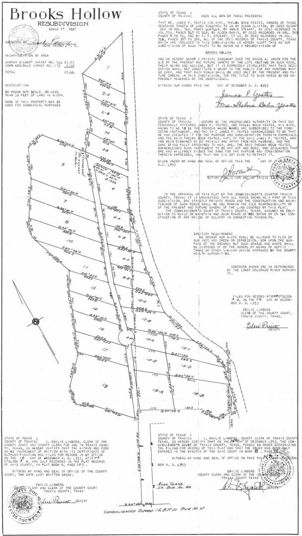

No lots were sold by reference to that 1950 plat, however. It was not until 1953 that Lake Travis actually refilled and there was some demand for the lots of BROOKS HOLLOW, none of which had previously sold. At any rate, in December, 1953, before selling any lots, the subdivider executed a resubdivision plat of the same four tracts of land known as "BROOKS HOLLOW SUBDIVISION". There is reason to think that Doak Rainey did send a field party out to actually stake lots in the subdivision as shown upon the resubdivision plat and that a number of the stakes placed by him or his assistants can actually be found.
Note that Lot 3 was resubdivided into two parts by the 1953 resub plat, but continued to share exactly one common corner with Lot 5. While the lakeward boundary of the subdivision is not explicity labeled "670' contour" as was done on the original plat, it would appear that the subdivider's intention was to subdivide the entire 15.15 acres that the 670 ft. contour bounded.

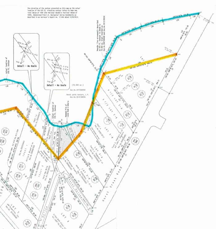

The problem arose when surveyors later discovered that the common corner of Lots 3-B and 5 was not in fact on the 670 ft. contour, but more than 124 ft. from it at the nearest point. The situation is shown in the detail below.
The blue line is the actual location of the contour with an elevation of 670 ft. above mean sea level as determined from the United States Geological Survey benchmarks" described in the 1938 easement deed to L.C.R.A. and in the 1945 deed by which the 15.15 acre tract was originally conveyed to separate ownership.
The orange line is the boundary of the subdivision as delineated upon the 1953 plat of BROOKS HOLLOW RESUBDIVISION.
In a nutshell, the question was where the common line of Lots 3-B and 5 actually ran to reach the boundary of the 15.15 ac. A dispute had arisen between the adjoining landowners fueled in part by the differing opinions of several land surveyors.

Proration produces some very wacky results, though, if consistently applied to all of the lake front lots.
Note that one feature of the subdivision scheme is the easement across Lot 5 on the resub plat labeled "Easement for Access to Water" This is used by subdivison lot owners to launch boats and to travel by vehicle down to the lake at levels below 670 ft. That is, there is an old concrete-paved boat ramp that runs from the platted line of Lot 5 down to the 670 ft. contour following a natural fold in the land, in the direction of maximum slope.

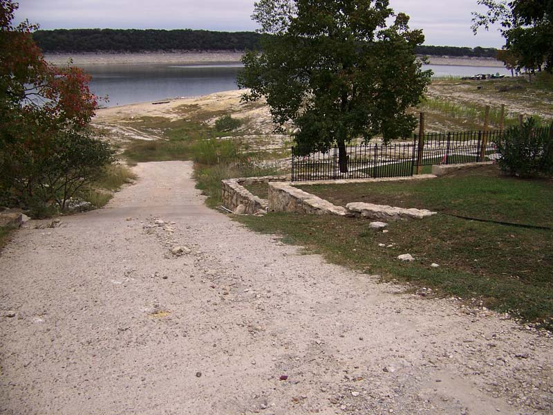

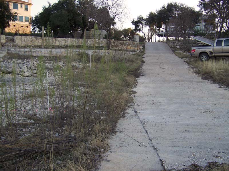

Here are two photos showing the concrete boat ramp in place running from Lot 5 toward the lake and ending at approximately the 670 ft. contour. These were taken at a time when the lake was very far down and would look quite different today.

Kent McMillan, post: 378647, member: 3 wrote: Note that one feature of the subdivision scheme is the easement across Lot 5 on the resub plat labeled "Easement for Access to Water" This is used by subdivison lot owners to launch boats and to travel by vehicle down to the lake at levels below 670 ft. That is, there is an old concrete-paved boat ramp that runs from the platted line of Lot 5 down to the 670 ft. contour following a natural fold in the land, in the direction of maximum slope.
Yes, I missed the easement. I think the construction you presented is a reasonable solution. Hopefully the land owners are agreeable.

Andy Nold, post: 378665, member: 7 wrote: Yes, I missed the easement. I think the construction you presented is a reasonable solution. Hopefully the land owners are agreeable.
They did agree to settle the lawsuit. My client was happy.
On a more general point, the idea of proportionment of frontage on a lake falls apart in the case of a variable level lake with the sort of topography that Lake Travis does. If the equity lies in each lot sharing the waterfront at all levels of the lake in proportion to the record frontage of the lot as shown upon some subdivision plat, then you end up having to do the proportioning along multiple contours, ending up with highly irregular side lines that don't most likely work in the way that people who own lake lots on variable level lakes expect them to.
On a variable level lake, one key element is that you can maintain a boat dock by moving it in and out as the lake rises and falls. a lot that facilitates anchorage and dockage works. One that merely gives some water front without regard to use, isn't necessarily even an equitable solution.
It's a different sort of problem than distributing accretions, for example.

Kent McMillan, post: 378650, member: 3 wrote: Here are two photos showing the concrete boat ramp in place running from Lot 5 toward the lake and ending at approximately the 670 ft. contour. These were taken at a time when the lake was very far down and would look quite different today.
2 questions-
Are the white pvc/conduit your line markers?
Is the shoreline susceptible to wave-caused erosion?

Rankin_File, post: 378678, member: 101 wrote: 2 questions-
The white PVC laths are mine to make the preliminary line readily visible. Most of them were in ground that required a hole with a 3/4" rock bit before driving the PVC lath.
The amount of erosion on the shore between 1953 and the present would be quite minimal considering that top soils are very shallow and are underlain by limestone of some form.
