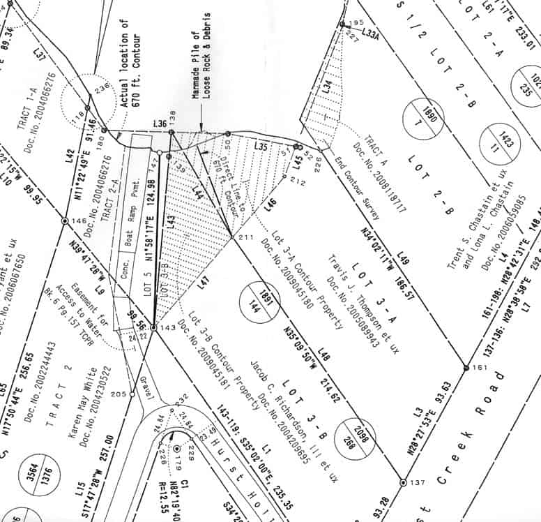

Bill93, post: 378683, member: 87 wrote: So the principle difference between the old survey and yours was 0.4 ft difference between the datum they used and NGVD29?
No, that was probably the most minor difference, although the 0.4 ft. vertical difference made a difference of feet horizontally in the position of the subdivision boundary.
The main differences were in the method of determining the direction of the common line of Lots 3-B and 5 and the title status of the land lying between the lakeward boundaries of the lots as shown upon the subdivision plat and the actual boundary of the land subdivided, the 670 ft. elevation contour. The horizontal differences in direction amounted to roughly six feet or more of difference in location, with one surveyor's theory placing the common corner on the concrete boat ramp, which would have been the point of departure for a new round of litigation.

Kent McMillan, post: 378637, member: 3 wrote:
Kent, nice, neat plan presentation. What fonts are you using in your plans?

Conrad, post: 378713, member: 6642 wrote: nice, neat plan presentation. What fonts are you using in your plans?
Here's a detail of that map full size so that you can see the font as well as the fact that I am extending pen plotting technology well beyond its natural life. I try to unclutter my maps as much as possible while at the same time putting more information on them than most surveyors do. The point i.d. nos. provide a neat way to key to a list of mark descriptions. a coordinate list, and to identify the same in reports.
The font is one that I created years ago that is based upon a version of a mono-pitch Courier that I use in two basic aspect ratios, mostly the condensed version.
I've been meaning to move to Bricscad and will need to find at least one condensed monopitch font.
