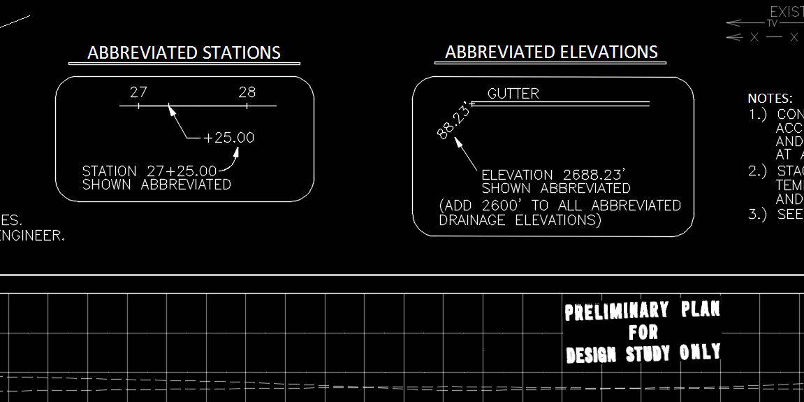

What is the thought regarding abbreviated elevations on plans. For example all of the elevations on the project fall within elevation 26xx' so you annotate flow line elevations as 88.24' meaning 2688.24'. This is pretty common on sketches...what is your feeling for using this method on project plans? If it is acceptable, do you think there needs to be a note or legend explaining the notation method?
Then how about abbreviated stations....you have even stations labeled 26+00....27+00 and label something in between as +54.23. Again acceptable on project plans? Does it require explanation on project plans?

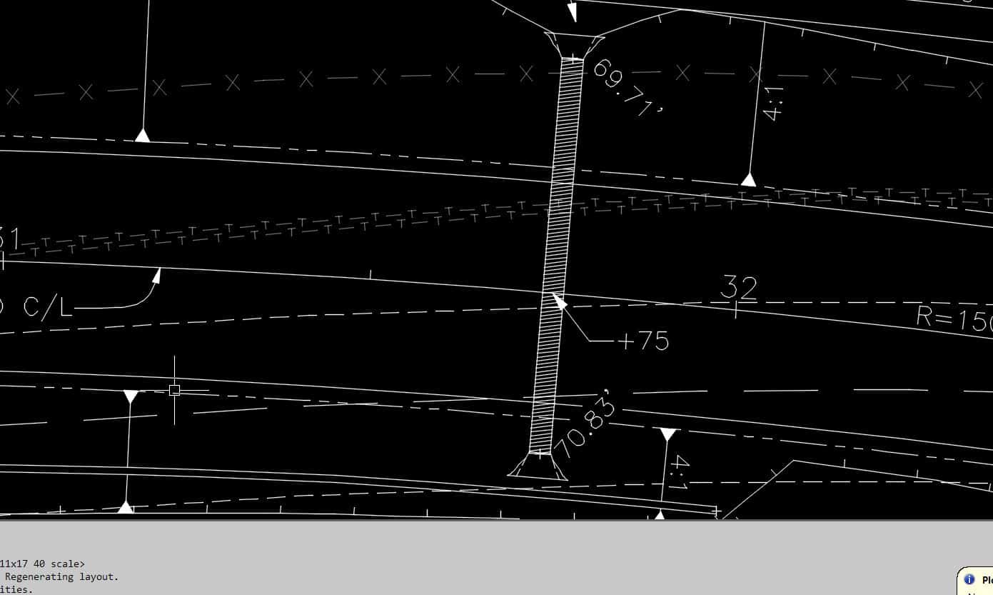

Ya, 1"=40' plans. Just trying to keep them clean.
Something like this...My gut feeling is that to avoid liability the full into should be shown...but I like how I have it now.

The plans are primarily directed towards a general contractor who would be responsible for interpreting the plans sufficient to correctly bid and construct the project. Of course a surveyor/engineer would be expected to understand them as well. I may be staking the project...maybe not.
Thinking of including something like this on the first sheet to spell it out.

The abbreviated stations I something I've seen several state Dot's use (I thought it was industry standard).
As for abbreviated elevations, I'd definitely keep the note explaining it. I can't imagine anyone giving you grief over something like that (especially if it's stated so obviously like you have it shown).

I see this as no different than drawing a zig zag on a line you are showing not to scale for clarity, add a note stating 2600' has been subtracted from elevations shown for plan drafting clarity, make the font of the note bold to assure it draws the readers attention, mention the truncation method in the transmittal to client.
