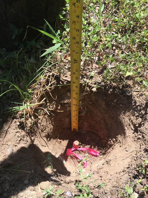

This is the excavation of Light, light work with a shovel to uncover an old survey marker that probably dates from 1947 given that it is a type of #5 steel rebar that wasn't manufactured after that and the subdivision was laid out then. In some older subdivisions, it's a sad commentary that one good clue as to the identity of an original monument is that it doesn't have any old scraps of plastic flagging tied to it as this one also didn't.

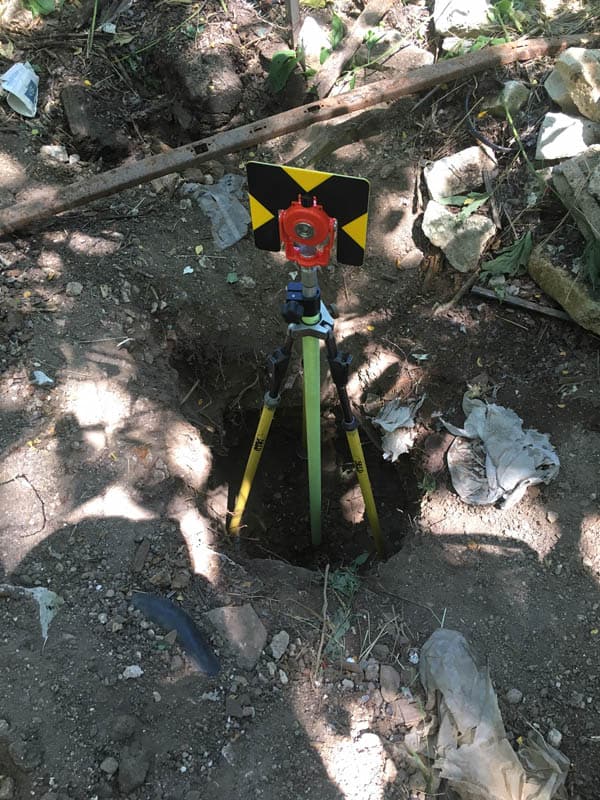

This hole of Darkness was what it took to be reasonably sure that no old survey marker still existed within about a 30-inch diameter circle of where all reasonable expectation would place it if it did. A surveyor nearly exactly 70 years ago reported marking this corner with an "Iron Stake". It was a hint that a surveyor a year later, in 1948, reported nearly all of the rear corners of the block in place, each marked by "I.P. Found" with the exception of this corner where he noted that he set an "I.P."

This particular investigation was in an urban area with what I'd say was a spotty history, a fact reflected by the need for thick leather gloves as protection from the sharps, mainly broken glass but with some used syringes mixed in, that formed a top level of occupation on some of the undeveloped lots. The hole of Darkness was on the rear of a lot along a creek where the concept of "fill" was taken to include everything from loose rock, car parts, ferrous junk, as well as actual soil material.

Kent McMillan, post: 433743, member: 3 wrote: an old survey marker that probably dates from 1947 given that it is a type of #5 steel rebar that wasn't manufactured after that
Wait...Can you really divine the pedigree of that stake from the inch or so that we see exposed in the photo? You're a better man than I......

Sergeant Schultz, post: 433763, member: 315 wrote: Wait...Can you really divine the pedigree of that stake from the inch or so that we see exposed in the photo? You're a better man than I......
I exposed about the top 1-3/4 inches of the rebar and that was enough to identify it as the type made to the pre-1947 specification with flatter, more widely spaced deformations than were standardly rolled after 1947 by US rebar mills. The ASTM spec for rebar was revised after research demonstrated that more, higher deformations performed much better in reinforced concrete.
