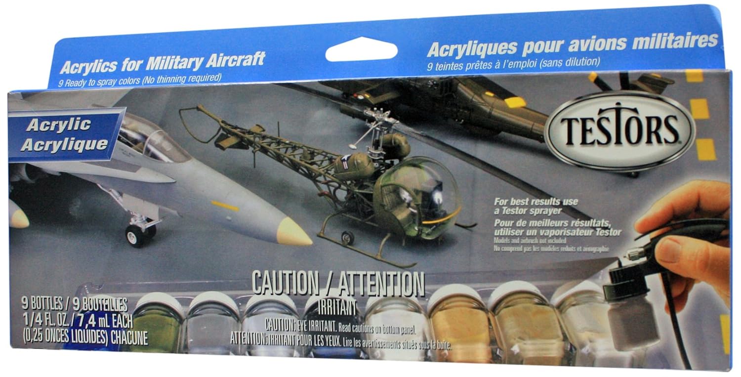

The products I used were as follows:
I dipped each model twice in Pledge-brand Acrylic Floor Finish with Future Shine (this used to be called just "Future" floor polish until the company SC Johnson bought the product line and merged it with Pledge.) I let each model dry for about an hour before dipping it again.
This is available from Walmart in a 27oz bottle for $6.18
Pledge Future floor shine at Walmart for $6.18
I then used Testors Model Master Acryl brand model acrylic paints to paint the instruments. - usually these are found at a hobby shop, but they can also be found at Hobby Lobby, Michaels Craft Stores, online at Amazon, etc.
I will find out the exact colors and post for reference- they were mostly from the 9-paint set for military aircraft (Olive Drab, Silver, Black, Navy Blue)
Testors 9-paint military paint set
Testors' paint
An exact color match to the Wild/Leica colors may be available in the Revell/Testors Model-Master enamel paints, which have more FS-specific paints- I'll check and post as well- (FS = Federal-Standard paints, which are spec'd to exact color chips used for the military)

I recognized the olive drab immediately. Lord knows how much of that color I've used over my younger, former years of model building. I figured you were using model paints.
Tamiya also makes some stuff that could be used as a primer in either flat white or black. I imagine that would work as well.
