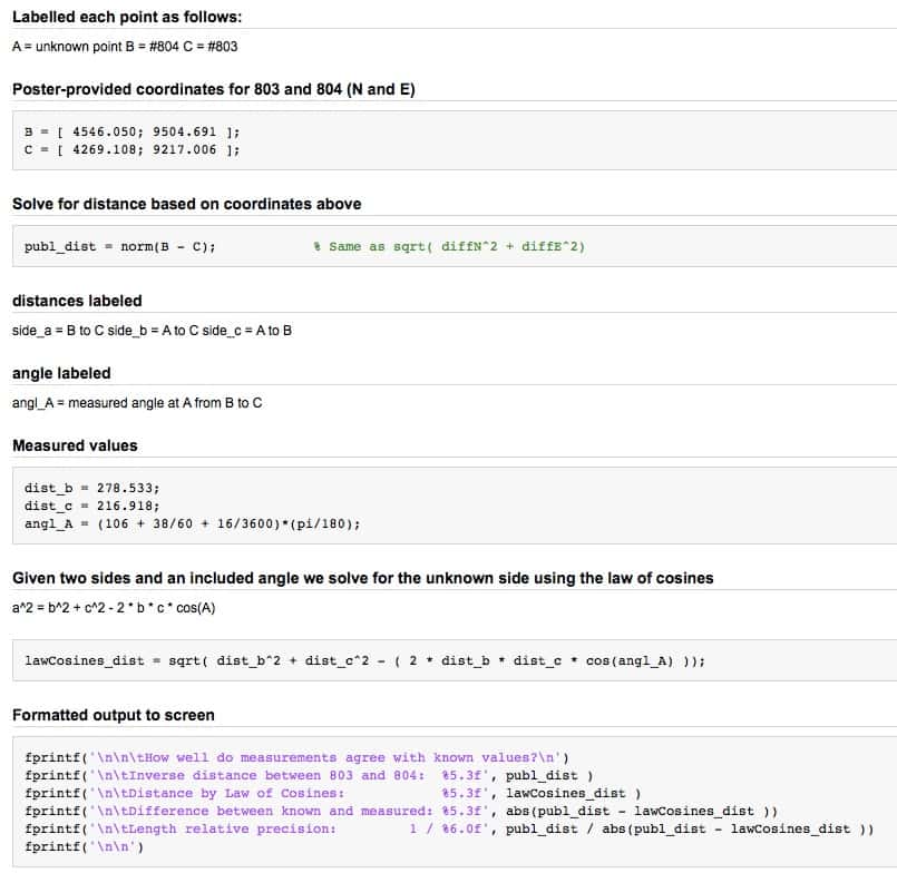

As you know better than I your accuracy needs, I provide the following comparison.
Inverse distance between 803 and 804: 399.324
Distance by Law of Cosines: 399.039
Difference between known and measured: 0.285
Length relative precision: 1 / 1403
Posted : May 13, 2016 9:09 am
GeeOddMike, post: 372071, member: 677 wrote: As you know better than I your accuracy needs, I provide the following comparison.
I would agree with your math.

You have a discrepancy between the published coordinates and your field measurements. Note that the discrepancy in the resection points is similar to the difference between the inverse and the indirect field measurement. Something has to give. Sounds like what the site really needs is updated control. Assuming that at the end of the day someone is going to build something on the site that might need to be within a position better than 0.25+/-.

Lets see 16 years ago some points were set and a local coordinate system was put on them.
Now you come back 16 years later and set on a unknown point and measure two distances and also measure the interior angle.
With this data you can check your old data (at least the distance between #803 and #804. I see no need to put coordinates on the unknown
point yet. With 2 distances and the included angle you just use the Law of Tangents, then the Law of Sines to calculate the distance between #803 and #804 (no coord. needed).
Your inverse between #803 and #804 (with your given coord.). is 399.324 ; no units were specified and none needed.
Now with your new field work ( and we done know how many times you measured the angle or with what type of instrument, nor do we know
how you measured the Horizontal distances, was the EDMI calibrated or did you use a tape?).
By using Trigonometry the calculated distance between #803 and #804 is 399.039 OR a difference of 0.285
Now this is not good but you would have to be the one that decides that. If working in a dump it would be OK(?).
I think you went about this the long way. Why did you not set on #803 and make a direct measurement to #804. You would have seen that something was wrong with the control from 16 years ago. That's if it was good 16 years ago.
