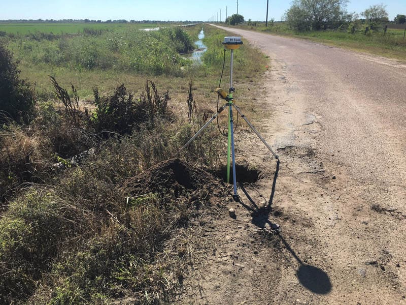

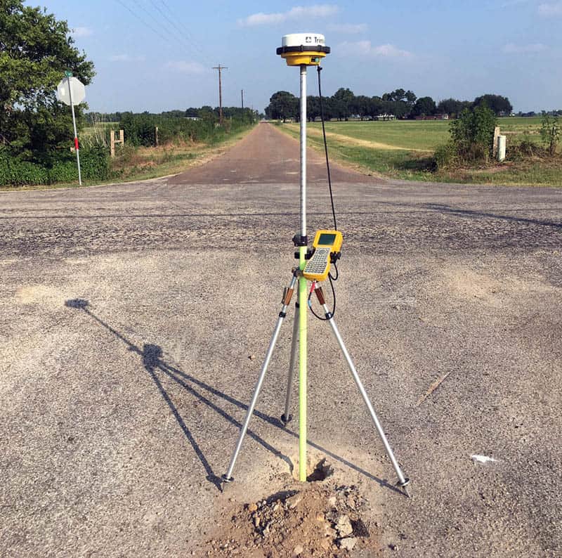

In May of 1950, a judgment was entered in the matter of Wharton County v. Colorado County a lawsuit to settle the common boundary of the two Texas counties. The judgment included a description by metes and bounds of the adjudicated boundary from a survey made following the instructions of the court.
The description began at a certain "post of railroad iron" that appears in the photo below which I've previously posted:
From that Railroad Iron, the boundary ran as follows:
"THENCE N45?ø24'E at a distance of 9,582.4 varas to a large sandstone buried near the center of a public road;
"THENCE N45?ø16'30"E at a distance of 11,483.7 varas (continuous chaining from the post of railroad iron at the point of beginning0 to an eight inch in diameter concrete post buried in the center of two intersecting public roads;"

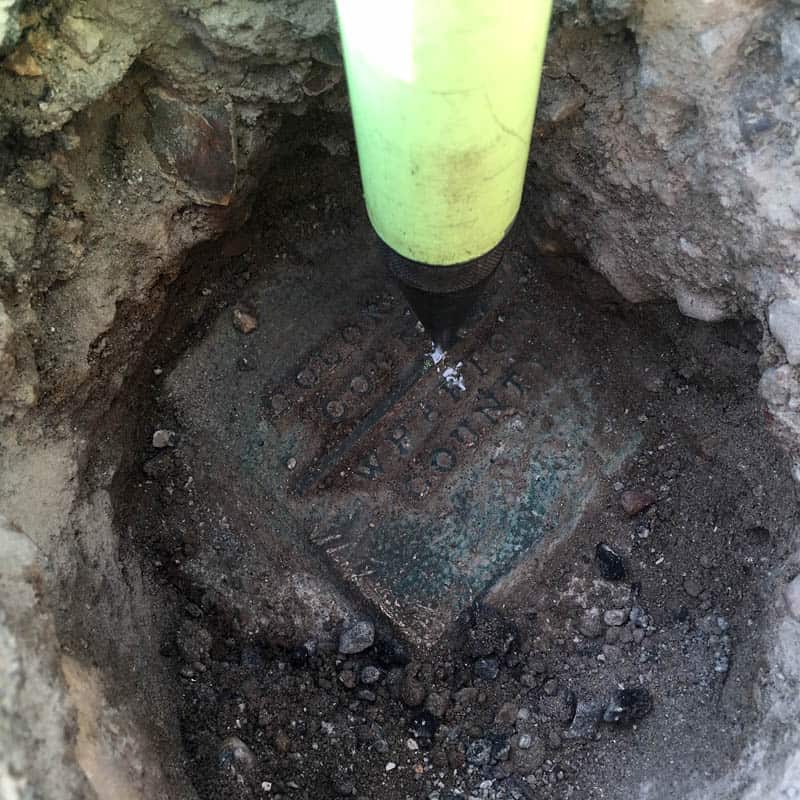

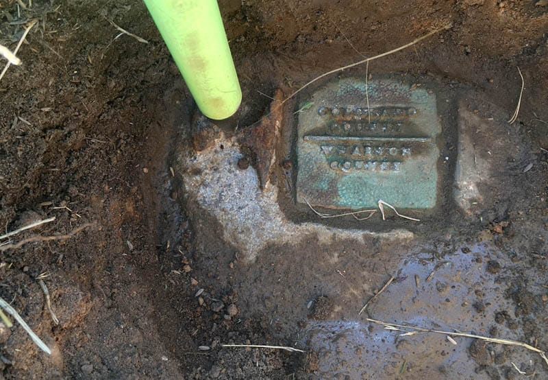

That concrete monument is what appears in the photos below that I posted the other day:
So, how did the surveyors do who in 1950 reported the distance between the two points as being 11,483.7 varas (= 31,899..17 ft.)? They really did quite well. According to my resurvey measurements, the actual distance is 11,483.975 varas with an uncertainty of +/- 0.006 vrs. (standard error). The difference of 0.275 varas between the 1950 survey and my resurvey amounts to an error of 1:41,800 in distances that were almost certainly taped.
Posted : June 25, 2017 8:40 am

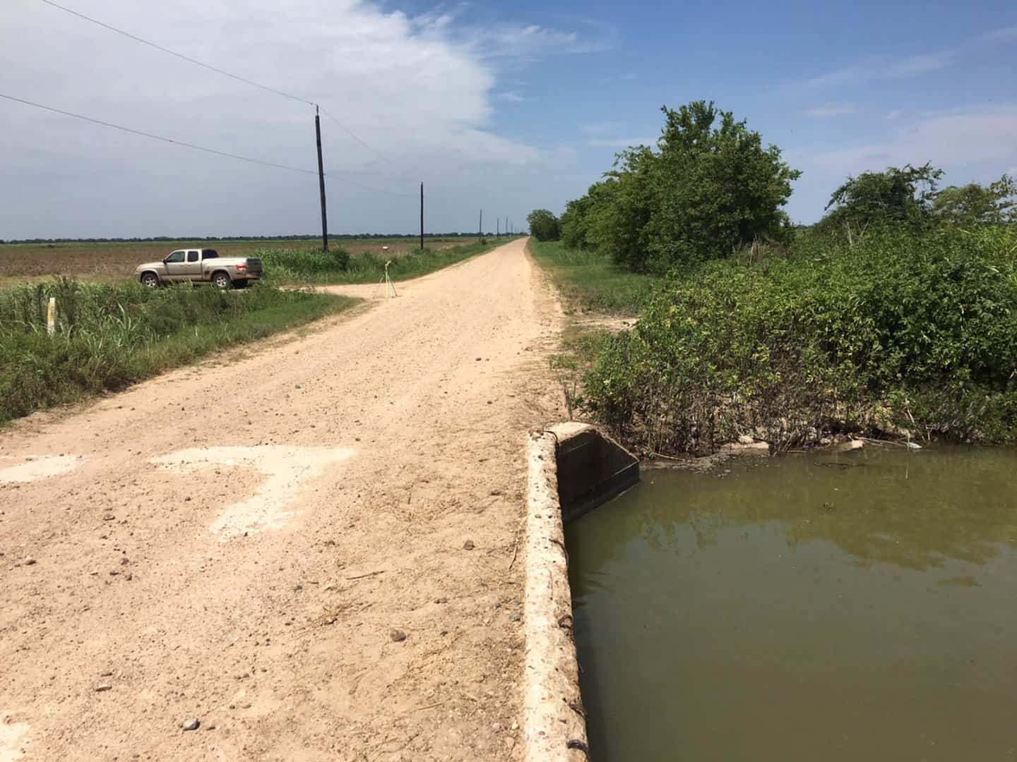

As an example of the terrain that the county line traversed in 1950, here's a photo of the vicinity of Mile 3 that probably looks pretty much the same as it did then, with the possible exception that the road gravel in 1950 was more likely rounded river gravel mined locally instead of the crushed limestone imported from elsewhere that is the top layer today. The GPS receiver in the background is set up on a Boat Spike that I found in place and determined to be 1.39' offset from the county line.
When I said the land was flat for most practical purposes, I wasn't kidding. The difference in elevation between the Boat Spike and the Post of Railroad Iron nominally three miles Southwesterly is only 3.49 ft. For the history buffs, this is in an area known as Lissie Prairie that in April, 1836 defeated the main force of the Mexican Army consisting of about 2500 troops, 1500 female camp followers, 1200 mules, and 8 artillery pieces when in wet weather they found themselves bogged down in the Mar de Lodo, a sea of mud that the silty prairie soil became, the same soil that a surveyor fifty years later described as "crawfish dirt". They left the Mar de Lodo a defeated and exhausted force, officers bootless and barefoot and troops spent.
