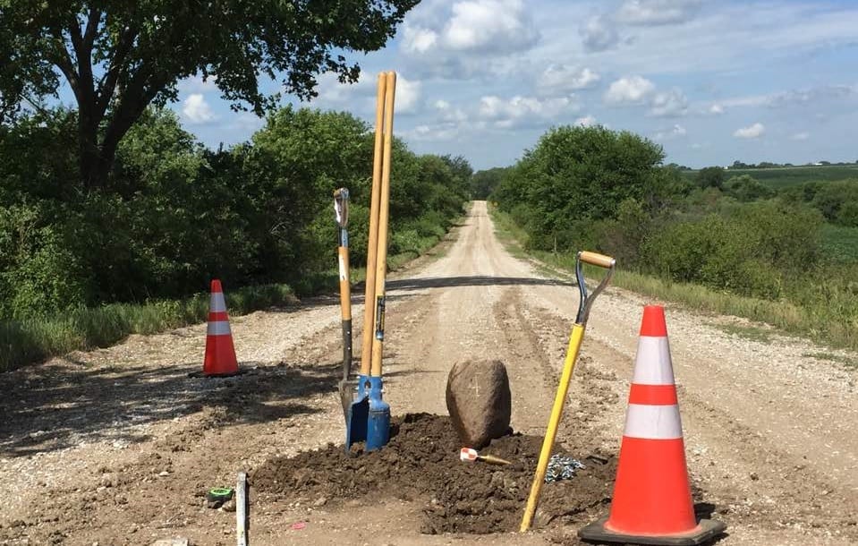

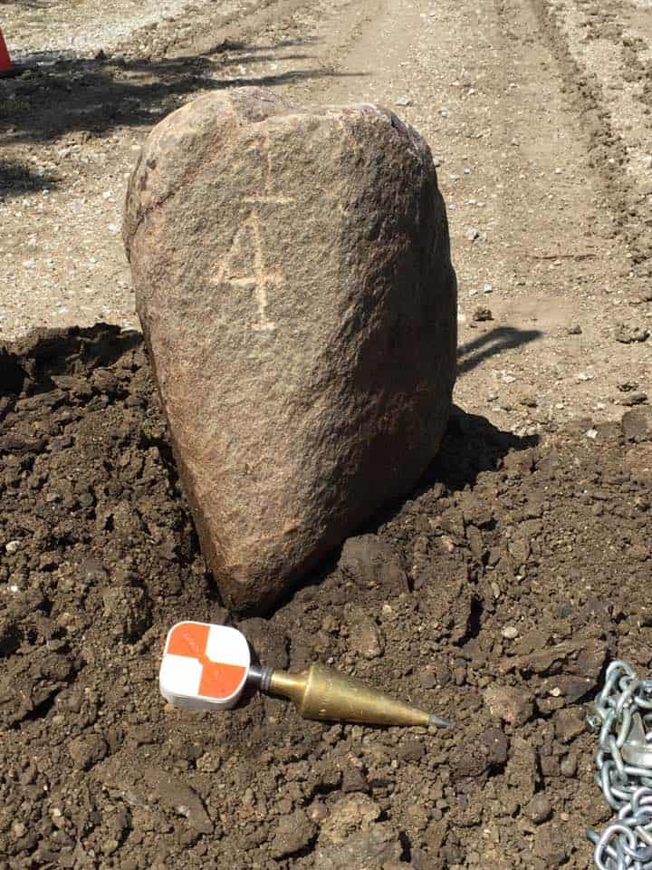

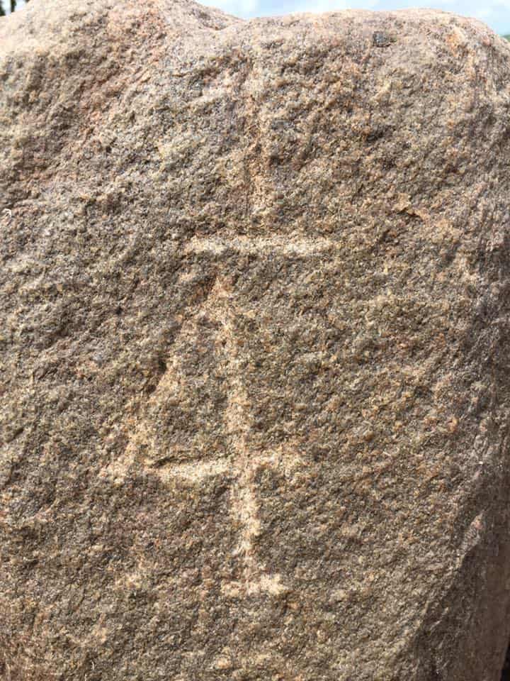

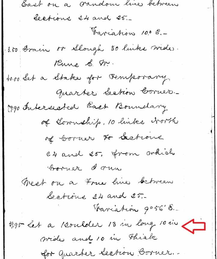

A recent find in east-west gravel road about 2' down. The 1/4 was correctly on the north face, but the longer side of the stone was oriented north-south instead of east-west along the measured line. I measured 15"x10"x9" and GLO notes state 13"x10"x10". June 18, 1857.

What is the practice these days for accessories? Back in the 1970s it was common to set crossed nails in fence posts or power poles. A gneissly chiseled stone.
That picture could be of anywhere in rural Lancaster County.

Pipe and rebar for reference ties. It's been a long time since I have seen cross nails, but that used to be the standard. Kind of like setting chair nails for bench marks.

Outstanding, seeing finds like this, is what makes surveying fun and exciting!

It looks like it is right in the CL of the road. Whoever is responsible for that road has been doing a good job.

We typically find undisturbed stones to be a bit larger than the stated dimensions. If it says three inches it is probably a strong four inches. If it says 12 inches it may be closer to 14 inches.
