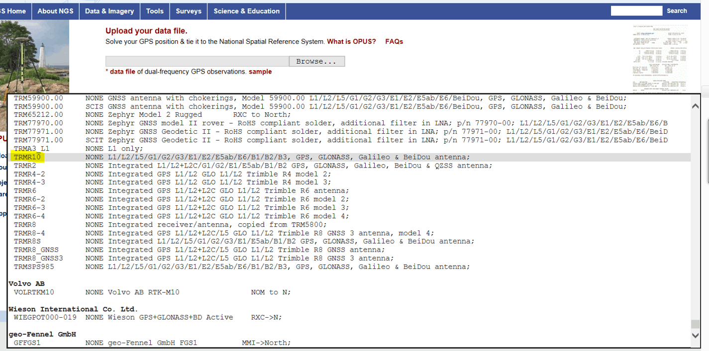

OPUS doesn't have an antenna type for an R10. Which one do you substitute?
Posted : May 11, 2017 10:27 pm
Ahhh, yes they do:
TRMR10 NONE L1/L2/L5....
It's right above TRMR2
Posted : May 11, 2017 10:30 pm

You should also be aware that OPUS references the ARP, which is the bottom of the receiver, NOT the bottom of the quick release. If you're using the quick release on a 2m fixed height pole or tripod your OPUS HI is 2.05m

Lee D, post: 428003, member: 7971 wrote: You should also be aware that OPUS references the ARP, which is the bottom of the receiver, NOT the bottom of the quick release. If you're using the quick release on a 2m fixed height pole or tripod your OPUS HI is 2.05m
I wondered where the .05 came from. The quick release is over .05 feet long though isn't it?
Posted : May 12, 2017 11:13 am
0.05 m = 5 cm = 0.164 foot.
