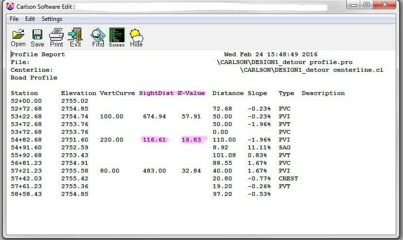

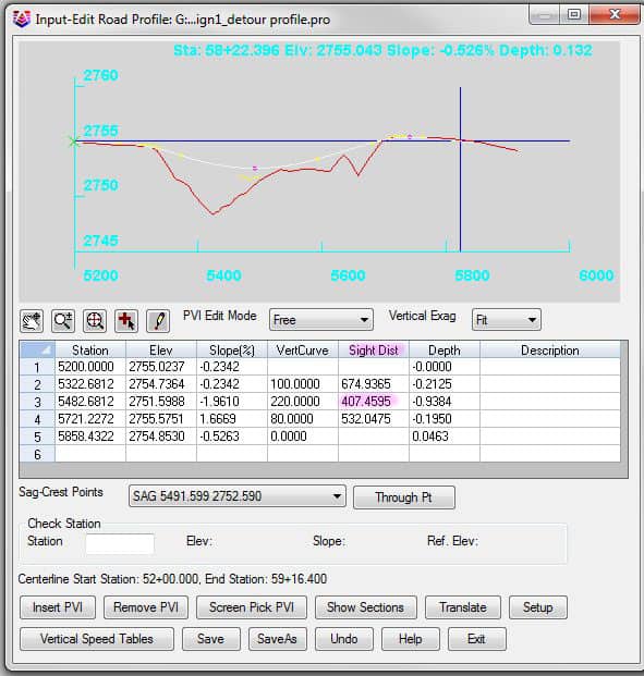

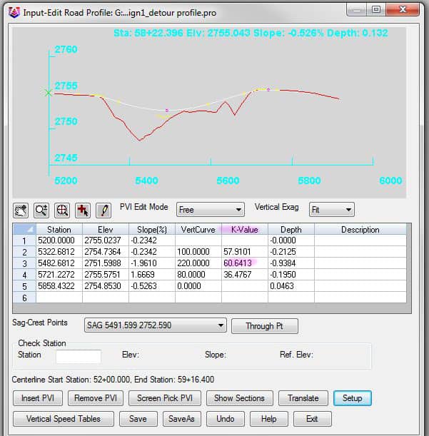

Would any of you Civil 3D users mind punching in this vertical profile and generate a report that includes the sight distance and K-value?
The criteria is 3.5 eye ht. and a 2.0 object ht. (stopping)
Station, Elevation, Vertical curve length,
5200.000 2755.024 -
5322.681 2754.736 100.000
5482.681 2751.599 220.000
5721.227 2755.575 80.000
5858.432 2754.853 -
I'm having some discrepancies in my software reports (specific to the 220 sag vertical curve) and would like to check the calcs. by hand. One report is stating S=407.46' K=60.64'.
The other report is stating S=116.61' K=16.83'
It is always nice to have something to check against while you are learning the formulas.
Thanks in advance if you can lend a hand.

This is what started this whole investigation.
My first issue was that the software didn't specify what type of sight distance it was reporting nor the heights used.
Posted : February 25, 2016 2:27 pm

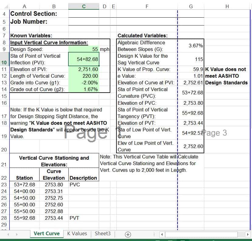

Dirt is cheap, just raise that vpi at 54+82 about a foot. :stakeout:
edit: that 11.11% should not be there.
James
Posted : February 25, 2016 2:36 pm
JaRo, post: 359701, member: 292 wrote: Dirt is cheap, just raise that vpi at 54+82 about a foot. :stakeout:
James
My point was that the sight distance and K values don't agree from one report to the next.
"Dirt is cheap"...Tell that to the permit folks...the fill is going in a stream bed.
Posted : February 25, 2016 3:08 pm
jaro
 jaro
(@jaro)
Posts: 1722
My smarta$$ comment was after looking at the first drawing. Just being funny.
After looking at the second report, there is a point that should not be there. That station 54+91 may be the low point of the sag but the software is figuring the slope from the VPC to the VPI to the sag 8.92 feet away and then to the VPT. Thats where the 16.83 K value is coming from and it's just wrong. That is where the comment about the 11.11% came from.
Not being familiar with Carlson, I'm at a disadvantage, but that point should not be in that report or at least the software should not be calculating a distance and slope to it.
James
Posted : February 25, 2016 3:18 pm

I'm immune to SmartA$$ remarks, so no problem there at all.
You are right on the money with the report using the sag station.
Turning that report option off changes the results.
Too many profile revisions and reports..my brain is spinning.
