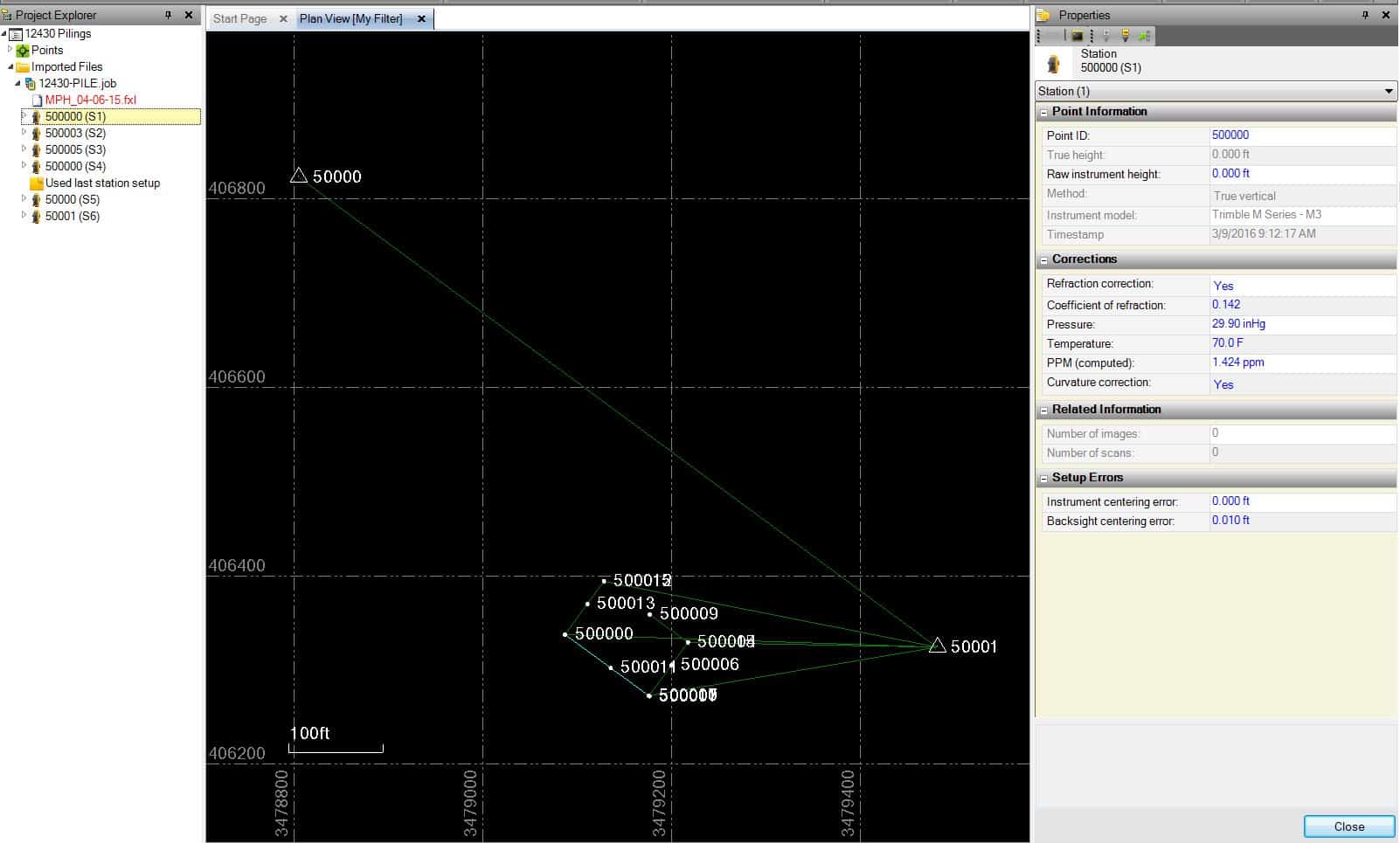

I just updated TBC to the 3.70 version. Exist projects seem to adjust ok. However I've created a couple of new projects using conventional (total station) traverses. When I go to do a least squares adjustment I get an error message that says "a network adjustment cannot be performed because earth curvature correction has been turned off for terrestrial data. Network adjustment requires curvature correction be turned on ("yes").
I must be blind or something because I cannot find where this setting resides to turn it on. I think I've looked every where there is in the project settings.
Any help would be very much appreciated.

Try going to the Project Explorer, expanding Imported Files, expanding your job, right-clicking on an instrument setup, and going to Properties - see the attached photo. If it's not turned on there turn it on.

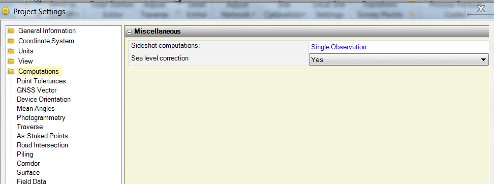

Try Project settings computations, Sea Level correction.
Posted : June 13, 2016 7:31 am
makerofmaps, post: 376923, member: 9079 wrote: Try Project settings computations, Sea Level correction.
Sea level correction? This is what Trimbel calls earth curvature correction?

Darn Lee. I was waiting for you to respond hoping you knew of a better way. That's the way I do it but it can be a pain on a traverse with 30 setups.

You should be able to select them all using Control or Shift then right-click and select Properties.

Thank you much Lee D.
I was digging through the individual observations and had skipped right past the set up point(s).
Surprised I had never encountered this before. Now I realize the issue originates in the DC when the .job file is first created.
All of our field crews had always had the correction turned on. It just so happened that this particular job came in the day after I had updated TBC and was going down the path of thinking the TBC update had changed a global setting somewhere.
Anyways problem solved and should have been obvious to me. Thanks again.
