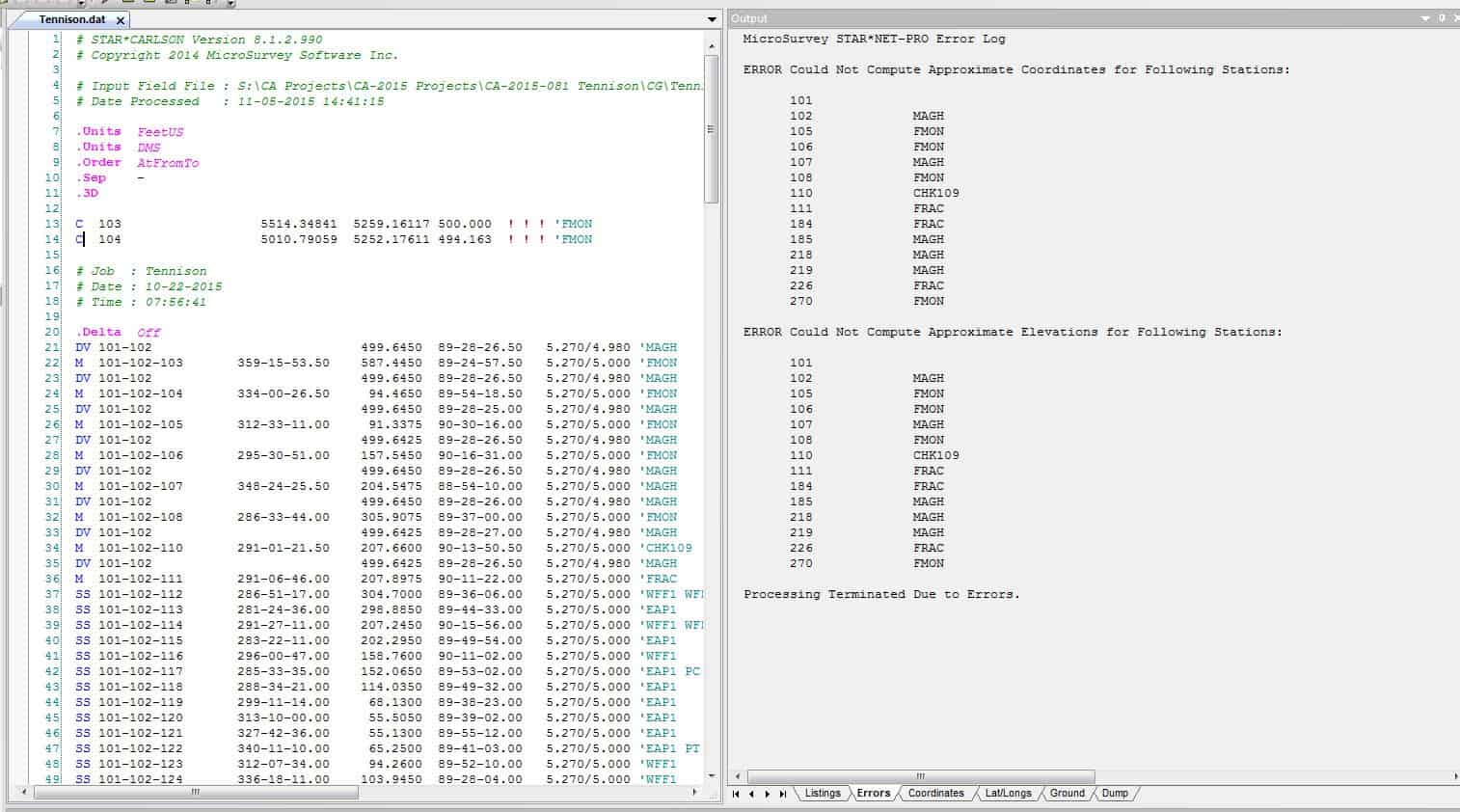

OK, I got the demo version of STAR*NET to kick the tires and see how great it is.
The first test bombed right off the bat when there Carlson converter failed to convert my Carlson RW5 file. Don't know what the problem is. The file runs clean through Carlson SurvNET. I sent it to MicroSurvey to look at.
So I moved onto another Carlson RW5 and it converted without a problem.

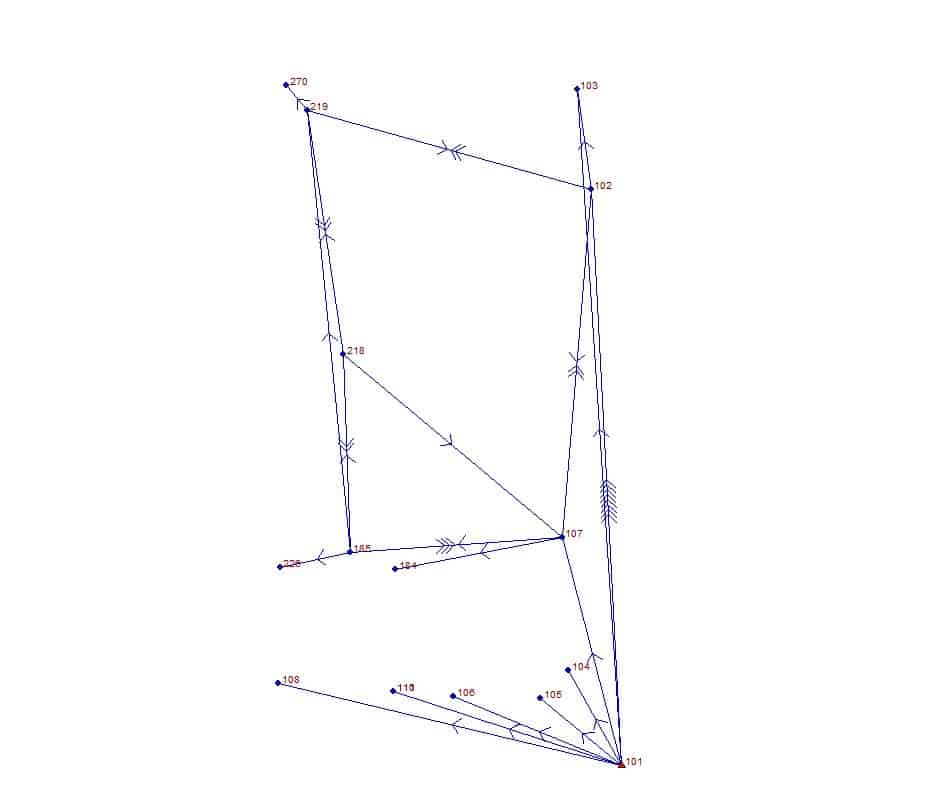

Here is the network:

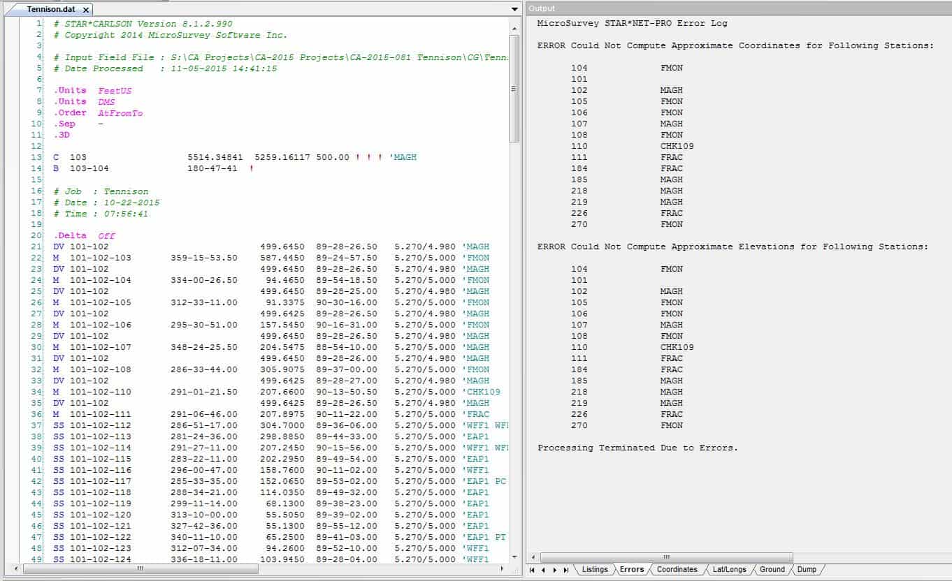

I tried to hold 103 and the azimuth between 103 and 104 fixed and this is what I got:
Any ideas why this is happening here? SurvNET does not have a problem with this. If I hold 101 and the azimuth between 101 and 102 fixed it will run, but that is not what I want to do.

Give 104 a coordinate and try again. Approximate is good enough, and let it float.
Posted : November 5, 2015 4:18 pm
ken-salzmann
(@ken-salzmann)
Posts: 634
While 104 is part of the network, it might be having a problem getting started. Assign a bearing on your first course, but let it float by adding an * after the bearing, or you can assign an amount to let it float if you know what it should be, and see what happens. If that does not work, just let it close without the fixed bearing to 104 and rotate the whole thing after running Star*Net.

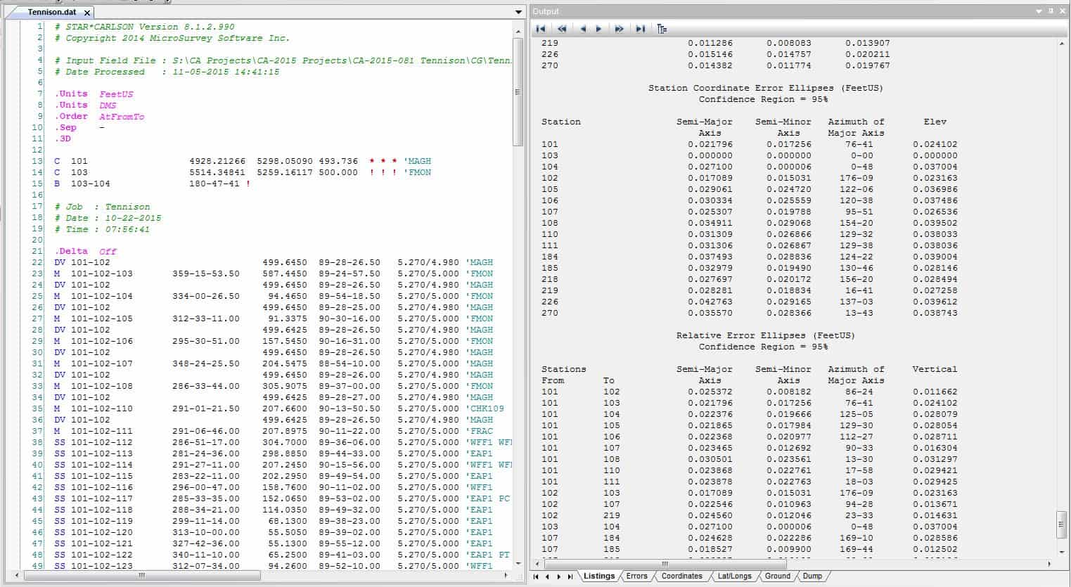

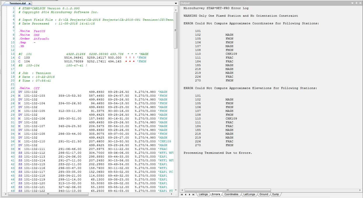

Bow Tie Surveyor, post: 343221, member: 6939 wrote: No dice that way either...
You have 104 fixed, it needs to float. Erase the exclamation points; no need to have anything after the coordinates, Star*Net assumes no fixity if the error values are omitted.

Haven't used it in years but wouldn't it want some kinda values for 101 and 102 to get started? It seems those could be anything as you're telling it to translate to the one fixed coord and rotate about it after it's done crunching the network.
Also, Jim said to let 104 float.

OK, after adding an approximate coordinate for 101 it ran. However, I gave it enough information to solve the adjustment before. Maybe they can fix that on the next version.

Jim Frame, post: 343225, member: 10 wrote: You have 104 fixed, it needs to float. Erase the exclamation points; no need to have anything after the coordinates, Star*Net assumes no fixity if the error values are omitted.
Nope. That doesn't work either. It seems to need to have an approximate coordinate on that first point or its dead in the water. They should fix that for the price they are wanting for this package.
