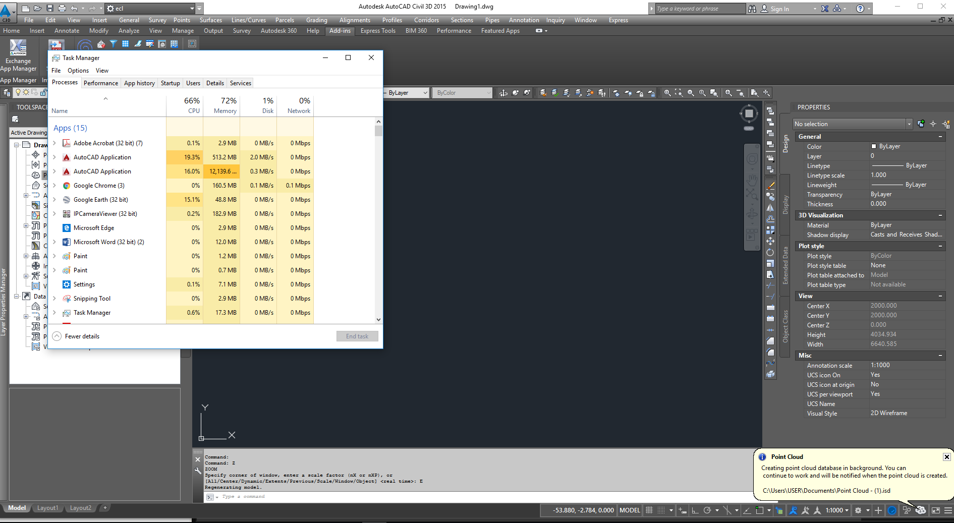

We use Civil 3D and our latest PC's and laptops are HP 3.2GHz i7, 32 GB RAM, Quadro 4GB graphics, Win10, SSD. Although the i7 does go into turbo mode, Civil 3D only uses one of the 4 cores (except for, I understand, one or two tasks like regen) so most of the time whole processor useage is (or was) only up to 25%. I say was because the latest ones seem to only go up to 15%. RAM is typically up to 9GB useage but that is when we have PDF viewers and web browser open as well. But as below I have seen some heavy useage when running two Civil 3D applications and doing some point cloud type work.

Interesting. I was running an i7, 16 gb ram, 256 ssd with a 4 gb video card. I would get up to 50 percent processor and 11 gb memory. Surfaces were generated overnight and took a nominal 5 hours to generate.
The new machine is i7, 64 gb ram, dual 512 ssd, 10 gb video. It will be interesting to see which software uses the tools..
