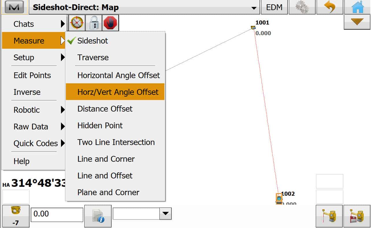

How do I do a vertical angle offset using Magnet Field to establish the elevation of the top of a tree or building?

Do you still have an "offsets" tab in the Side shot menu? If so, pick the Hz-Vt angle, position the prism directly below the object you're trying to locate, take the shot, then turn the vertical angle.

Go to Survey >Topo
Click on the "M" magnet logo in upper left corner
Now select Horz/Vert Angle Offset as Stephen mentioned above.

Keep in mind that if you can't get directly under the point you're trying to locate, your answer will be wrong.

Thanks Guys, that did the trick.
