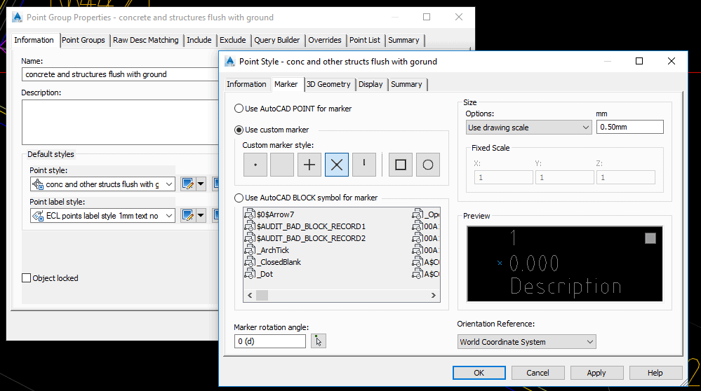

When using Civil3D and creating a Point Style, you are given the option to use the drawing scale size in inches.
Couple of questions:
1. I assume the scale is a reference to paperspace size. Correct?
2. How and what is being scaled/sized to be the size?

The symbol you choose to mark the node location. The text size for the labels would be set up under the label style settings. It will scale to whatever you view your are currently in is set to be it model space or papers space. We are still on 2010 but I assume it's still that way in the latest versions.

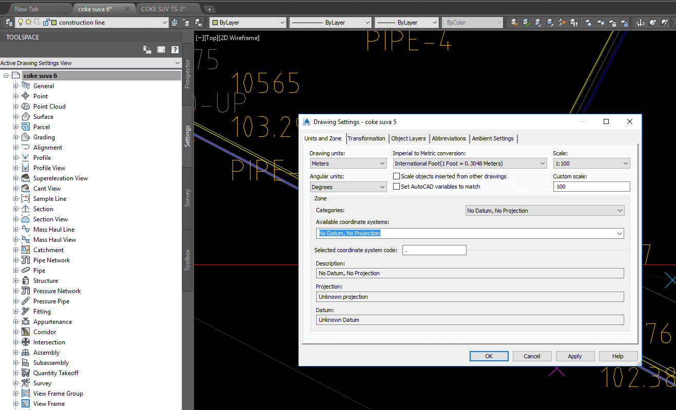

I think it is related to the drawing setting scale:
Posted : February 14, 2017 7:28 pm

The short answer toyour question is yes, but......getting the block to appear at the right size in paper space (at whatever scale) is controlled by a couple of different factors. Is the block annotative? Is the point style set to fixed scale or drawing scale?
IMHO, the best way to create a point style is to create a NON annotative block at 1:1 scale. Test how it looks by creating a 1:1 viewport and test print it (so you know what it will look like printed by YOUR printers). Once you are happy with it, assign to the point style. Now you can control the scaling effect of the block through the style editor (shown in a screen shot in the post above this one).
The advantages of doing it this way are:
1. Non annotative blocks don't have to have specific scales associated with them to be visible in viewports.
2. you can "Cap" the scaling effect for certain blocks. For instance, a small symbol for a water meter may look good at 20 scale - but at 100 scale it can show up as wider than the sidewalk itself. So for that specific symbol, you can use absolute units or a fixed scale.
3. All your blocks will be consistent. You insert them into other drawings (your older drawings, or from a client, etc..)and wont have weird scaling issues.
