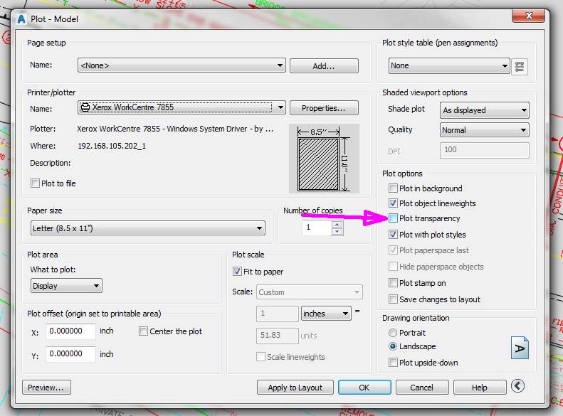

I have had this happen a few times and usually it was w/drawings that didn't really "need" images attached to them, but now I've got one the client wants, and I cannot get the image to plot. I inserted a GeoTiff and it shows up in the plot preview, but when I plot it, no image, no image frame, nothing but the lines I have on the drawing (as drafted). I'm sure it's just a setting or something of that nature, but I cannot figure it out, nor do I see another topic about it. I'm plotting from paper space also, don't know if that matters or not.

Ok, here's what we've found so far on this one. If you do not alter the aerial at all (i.e. shading etc.), then the aerial will plot. However, the bad part about this is, you cannot read the text or see much of the line work if there is dark canopy on the aerial. Anyhow, if you alter the shading, the aerial will not plot. Still no patches from Carlson that I see. Oh, it also will not print to pdf if the aerial has been altered either.
Posted : September 28, 2016 12:24 pm
Try unchecking this setting to see if it is what is causing problems.
I cannot print to a Xerox if this is checked. I have to plot to PDF then print from Adobe. PIA.
Posted : September 28, 2016 3:43 pm
When you select pdf, it will spool the entire file and any image files will follow.
To print on paper you may need to select "print image"
Posted : September 28, 2016 4:36 pm

The image does not show up when we print to pdf either. The image is not present in the print preview window, nor does it show up on the pdf either. Called Carlson, they said "this is a known issue with no fix as of yet".
