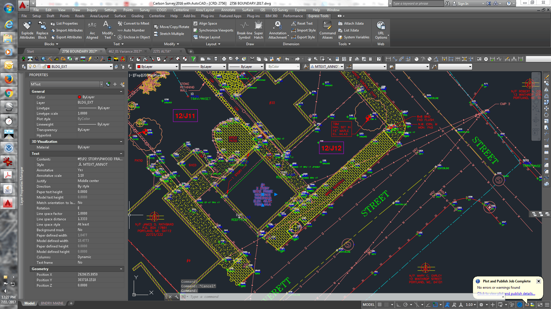

We use ACAD w/Carlson, so not sure if it will work for you but does your properties box have a "background mask" option?
If so, select it, choose background for color, and you should be all set.

We use Carlson with ACAD, so don't know if it will work for you, but do you have "background mask" in your properties box? If so, select it, choose background as the color, and you're all set.
