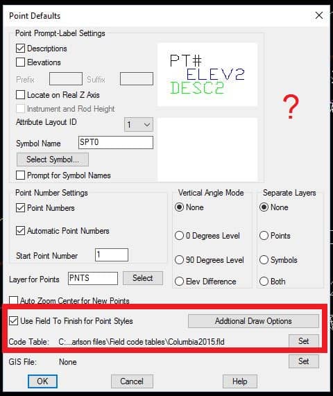

I am transitioning over from Carlson Survey 2013 to 2016 and I am having problems getting my point layers to behave as i had them in 2013.
What I like is when I do a draw/locate points, I want the point nodes to be on the layer per my field code table, but not insert symbols or anything else (I do all that in Field to Finish).
Carlson 2013 had a check box to just this in the Point Defaults
However, In Carlson 2016 that has gone away.
They do have a check box to use the field to finish for the point styles which does what I want for the point layers, but it also inserts the symbols and replaces the field codes with the full field code descriptions, which I don't want.
Does anyone know how to get the Carlson 2013 functionality back?

It isn't in the new version....I had the same issue. To use the field to finish code tables to sort layers is an all or nothing deal as it was explained to me. I used to do as you are, but now I have switched to mainly using the field to finish to draw my points (You will get used to pretty quick).
Hopefully Carlson returns the function to what it was (I was told there have been many complaints). That said, my overall suggestion is to let field to finish draw your points with the symbols.
Another note is to not use the symbols Carlson supplies outside of trees and points. I had a terrible time using a lot of there symbols outside of the points or trees libraries.

I was told by programming that "The "Use F2F..." now uses all the F2F properties and you can‰Ûªt do layers only."

Ladd Nelson, post: 373268, member: 307 wrote: I was told by programming that "The "Use F2F..." now uses all the F2F properties and you can‰Ûªt do layers only."
It would be great to get that functionality back. If I am just doing COGO calculations, I don't want to see a bunch of extra junk cluttering up the screen. And I am not sure why anyone would want to see the full code description on their points nodes. I like to have my points nodes be as compact as possible to make them easy to discern on the screen. When I use my "FRAC" field code, I don't want to see "FOUND IRON ROD AND CAP" on my point node. It just clutters things up.

I believe you can do what you want using Point Groups. Check just the symbol box and description box under "draw locate points" and insert them using the Point Group radio button. If you have field to finish set up correctly, your point groups will all be created the first time you run through F2F. Then it's just a matter of drawing the desired group as needed.

If you want just the field codes as your descriptions.....In the field to finish setup boxes make the three lines were you enter description data the same as your field code. If your firm is smaller and everyone knows the codes, then this route works great. Larger firms, where the knowledge of what the field codes represent gets worse the farther from the survey department the CAD person is, have more use for the full description.
Another trick that might help is to reduce the attribute scale to .025 on the first tab of the F2F coding field (This will make your labels smaller) while leaving the symbol scale on the second tab at 1 (Which will scale your 1 to 1 drawn symbol to the proper drawing scale).
