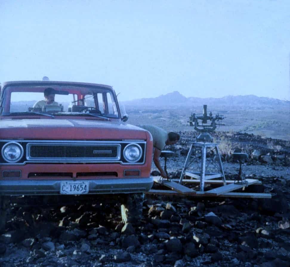

NGS Astro Party 1970s... Showing Wild T4 note the stand, observing stools and platform to isolate instrument from observer movement.

WOW, a cornbinder!
We had those at the USFS (GSA vehicles) back in the day too.
