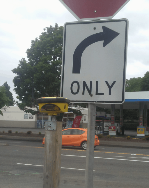

Nothing to see here, keep moving...
BM in base of sign

[SARCASM]It's an R8s- it'll sort everything out......[/SARCASM]

Has to be a DOT crew (or not)!

Base for machine control / BIM. No excuses about a pre existing monument being near the sign. They chose this spot. Luckily for them multipath filtering is pretty good these days.

It goes [way] beyond "just" multipath concerns.
If you have big ass (or little ass close by) signs, trees, buildings, trucks WHATEVER, the base/rover is NOT seeing all of the birds. In the case of an RTK Base Station, you want/need that baby in a place that "sees" EVERYTHING. Rover locations are what they are, and if they stink, then you need to move out of the "shadows." In any case...stupid is as stupid does.

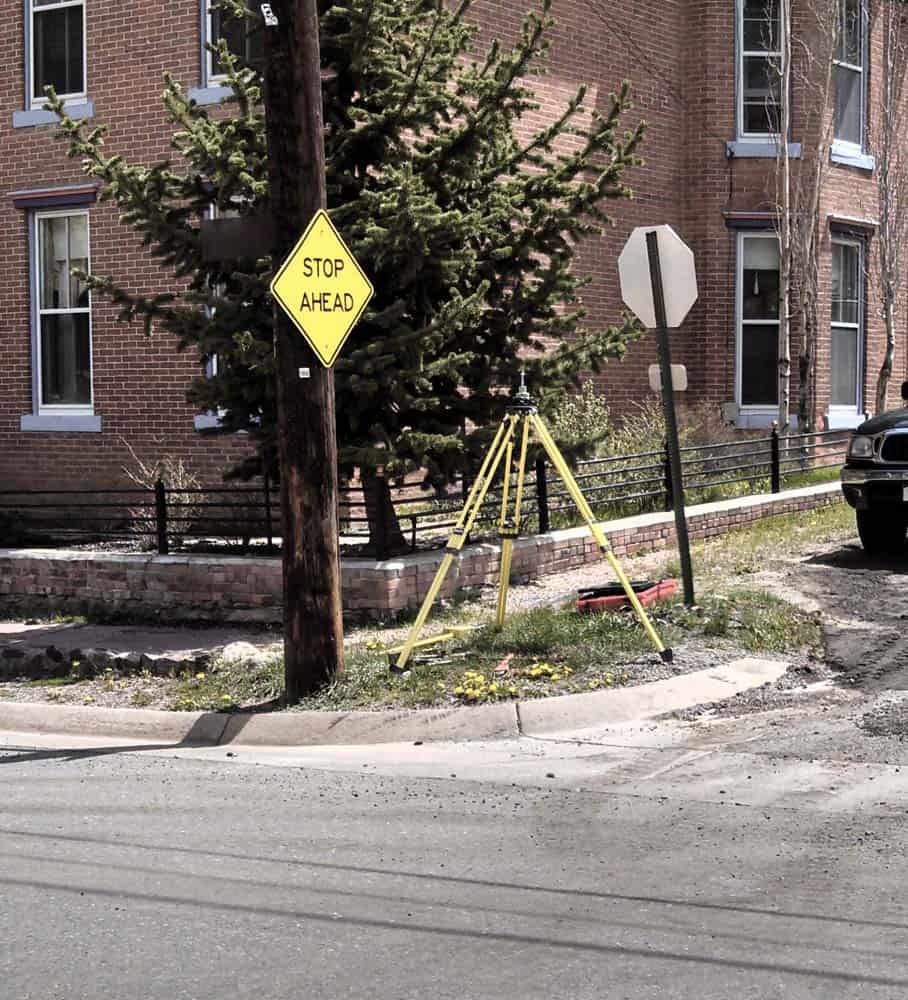

This is a conventional control station that a peer new to GPS wanted to establish geodetic coordinates on, so he got them with a single 3 hour occupation via OPUS. Remarkably, the OPUS overall RMS was a mere 0.022, but the latitude peak-to-peak was 0.005 m, longitude peak-to-peak was 0.168 m, and ellipsoid height peak-to-peak was 0.154 m.
Photo taken at noon so the house and tree are to the southeast. Photo cropped to protect the guilty.
And yes, he did get the Leica gear out of the box and turned it on. 😉

The occupation shown in the picture I posted was to get a position only for recovery, not for a BM tie. Still, I imagine the data is pure crap. But it is a good example of a bad occupation.

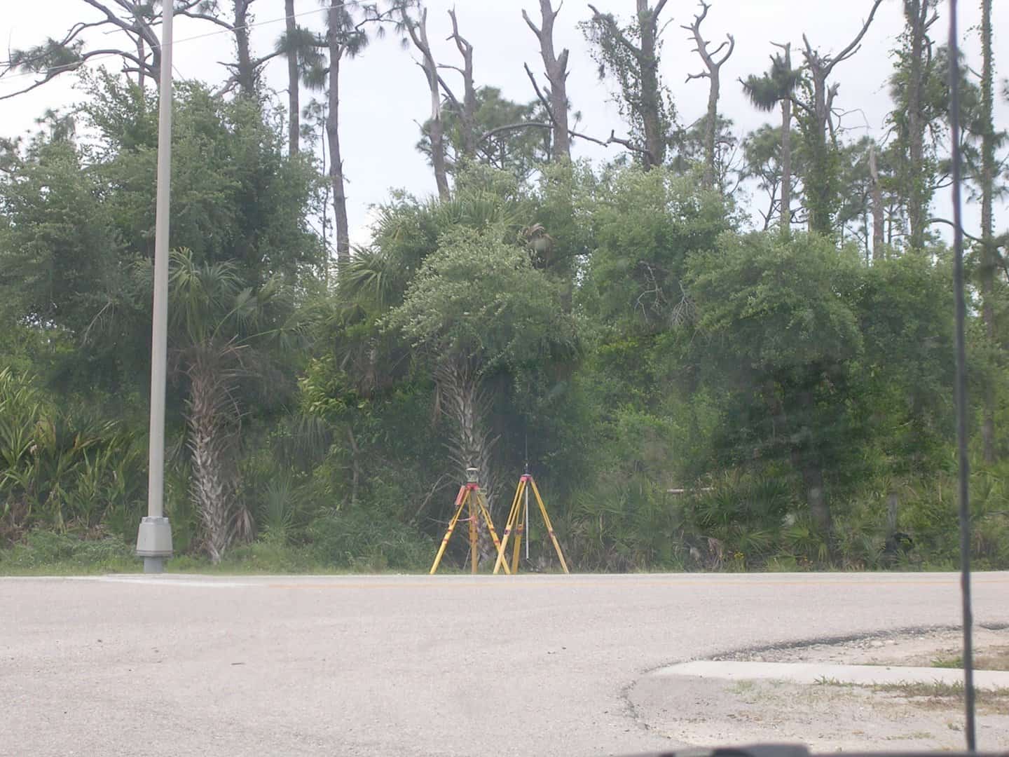

Here is a setup I saw once in Florida...
