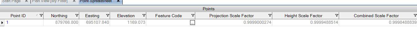

Not sure how you got the scale factor you wrote on there from TBC... here's what TBC reported for the scale values when I keyed that point in. I think the very slight difference from OPUS may be because I keyed it in as Global instead of Local (or Grid).
Posted : April 22, 2016 3:28 pm
Lee D, post: 368881, member: 7971 wrote: Not sure how you got the scale factor you wrote on there from TBC... here's what TBC reported for the scale values when I keyed that point in. I think the very slight difference from OPUS may be because I keyed it in as Global instead of Local (or Grid).
Lee,
You used the "ortho" Height in TBC, which is NOT the correct Height to compute a "vertical Coefficient" (height factor).
I keyed the Latitude and ELLIPSOID Height into my program, and got:
(Vc) 0.999 948 732 x (NGS grid scale) 0.999 900 03 = (cf) 0.999 848 767 which agrees with the NGS value (rounded to 8 decimal places).

Actually no I didn't you shouldn't authoritatively state a false assumption. I keyed in the lat/long/ellipsoid height from the OPUS solution as a Global coordinate, the grid value is just how my Point Spreadsheet is configured to display it. If you DID know anything about "Trimblese" you'd have known that a Global coordinate can ONLY be a lat/long/height.

I apologize for ASSUMING (anything) before fully analyzing the data...I am sorry about that, and will try to be more conscientious in the future. The spread sheet format DID throw me for a bit of a loop, BUT I should have dug a little deeper BEFORE opening my big mouth (keyboard).
I reran the numbers to figure out WHY the Trimble EF (Vc) was different that the NGS (and my) Values.
It appears that Trimble is using the East-West Radius of Curvature at the subject Latitude, instead of the "mean" Radius of Curvature at that Latitude.
The numbers that I get are as follows (@ 33å¡25'06.31968" GRS-80):
R = 6,384,622.506m = 0.999 948 851 East-West Radius
R = 6,369,703.880m = 0.999 948 732 Mean Radius
R = 6,369,686.410m = 0.999 948 732 Geometric Mean Radius
R = 6,369,721.351m = 0.999 948 732 Radius of Gaussan Sphere
In this (and most) case(s), the variance between the various "means" fall well into noise, but it's pretty obvious that the NGS (and my program) are using one of the "mean" values (actually my program generates ALL of them, and I generally use the "simple" Mean value).
I'm sure that arguments can be made for NOT using the Mean Value (any of them), but I tend to try and match the NGS Numbers whenever I can...

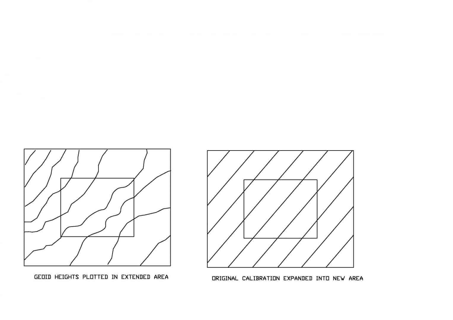

The Reason for 4 points is to be able to calculate error. Take a sheet of paper and lay it on a table. Now fix one point to the table. This is a one point localization. If you are lucky and the table is level then you will hit close to the rest of your points on the sheet and it appears correct. But what if the table is not level? Then your one point wont work. Two points still might not. What if the table is out east and west but not and south is level. well if the two points you localize on are also north and south, everything in between those two points will be good. The further east or west you go the worse they get. The only way to know you are right is to make sure all 4 corners of the sheet are correct. 3 corners will work but you need 4 to see your precision.
Posted : April 23, 2016 4:27 pm
Good explanation NWFL50. I wished I'd a said that!
Posted : April 23, 2016 5:29 pm
Kevin Samuel
(@kevin-samuel)
Posts: 1040
NWFL50, post: 369055, member: 11623 wrote: The Reason for 4 points is to be able to calculate error. Take a sheet of paper and lay it on a table. Now fix one point to the table. This is a one point localization. If you are lucky and the table is level then you will hit close to the rest of your points on the sheet and it appears correct. But what if the table is not level? Then your one point wont work. Two points still might not. What if the table is out east and west but not and south is level. well if the two points you localize on are also north and south, everything in between those two points will be good. The further east or west you go the worse they get. The only way to know you are right is to make sure all 4 corners of the sheet are correct. 3 corners will work but you need 4 to see your precision.
A 1 point vertical localization followed by checking other points can be used to verify the solution in the same manner. A 4 point vertical localization is not necessary to verify the vertical validity of the localization (at least in TDS Survey Pro and Foresight DXM).
If the one point that is chosen is keyed in with a blunder, the effect is obvious in the verifying process.
I agree that some form of verification must be conducted.

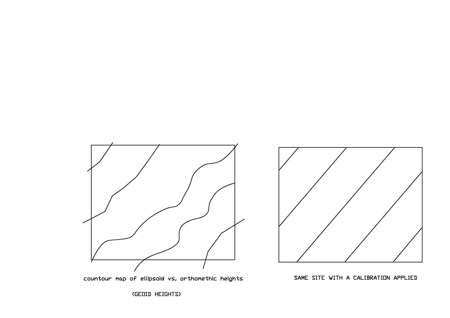

Posts: 10534
Posted : April 24, 2016 10:01 am
Posts: 10534
And then this happens
Posted : April 24, 2016 3:40 pm

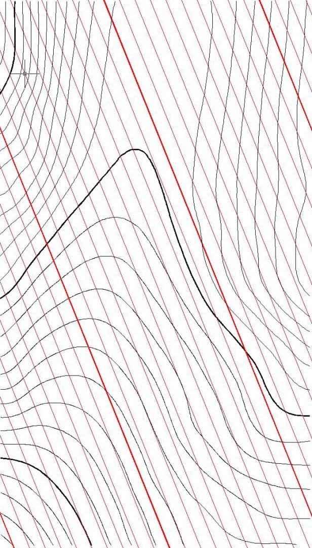

As a follow up on Mighty's posts above,
Here's a larger version from a recent project.
Oh yeah... and the "inclined Plane is inclined the WRONG direction too!
