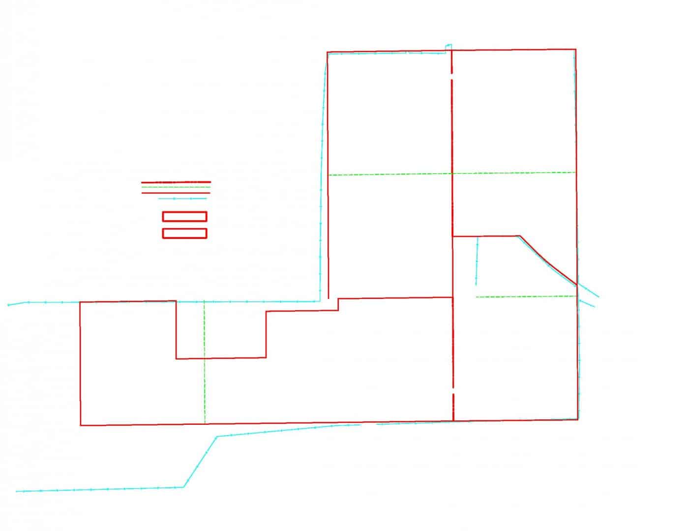

Lets look at the real world:
I just finished a survey of two properties that needed to rearrange their common lines, this wasn't to deal with boundary issues, they had different reasons to do it, however, along their exterior lines there are occupations that don't line up the their deeds.
To just move 1/16th and a missing 1/4 to occupations would have been wrong in this case IMO, maybe someone else would differ, but at the end of the day the DEED was staked. Did it match up with occupation? No.
Often surveyors are not going to solve all boundary issues in the field, and the DEED should be staked as written, fences are sometimes just fences even when they are used as division lines. Do I see these landowners going to court over the occupations,,,,,,,,,,,,,,NO, but you never can be sure.
To further complicate things, this property is in a township next to one the BLM is retracing, there is extensive mineral development near, much of the mineral ownership for this survey is fee but not all, so it may well be subject to a BLM retracement in the near future, and I will always consider that when any section, 1/4 or 1/16th is monumented, the BLM WILL NOT accept any of those fences, that I do know.
So saying you will go out and solve occupations here yourself during a survey, really? How as a surveyor would you do that?

Yes a lot goes into it when looking at fences, the diagram above is an indication of what is going on with these fences.
Not knowing more than just the geometry can direct anyone to some important conclusions about these fences.
I can tell you that the people on both properties that I surveyed are descendants of the patent holders.
These fences are old, not all in their original locations for many reasons, but they have been in place for a long time.
Say you accept the fence corner along the west line which is the SE1/6. It's 120' from the math position, it's there for a reason unrelated to a section breakdown, as you move north it has a strong NE bearing, again unrelated to math, and it angles more than once, do you angle along it, setting at least 5-6 maybe 7 monuments along the 1/16th line? You could do that, not sure how you would justify it.
There's roughly 4 acres between the fence and the deed (math section breakdown), not real valuable surface land, but there is mineral development in this township, lots of it, and a payment of $80,000 an acre for coal for just the right to lease has be made to mineral owners, which both landowners are.
So yes, we talk to the landowners, we see why fences are where they are, we make decisions about section breakdowns, but at the end of the day the DEEDS are very, very important.
The math has never meant much to me. I don't think that way, maybe because sections in my area often will have 1/2 miles record of 2640 but measured of 2460, or 4260 and weird bearings, makes you think differently, but that doesn't mean every situation can be solved by a surveyor, sometimes we can only show landowners issues they have, which is surveyor-in-training's point, and it is a very valid point that should be respected.
