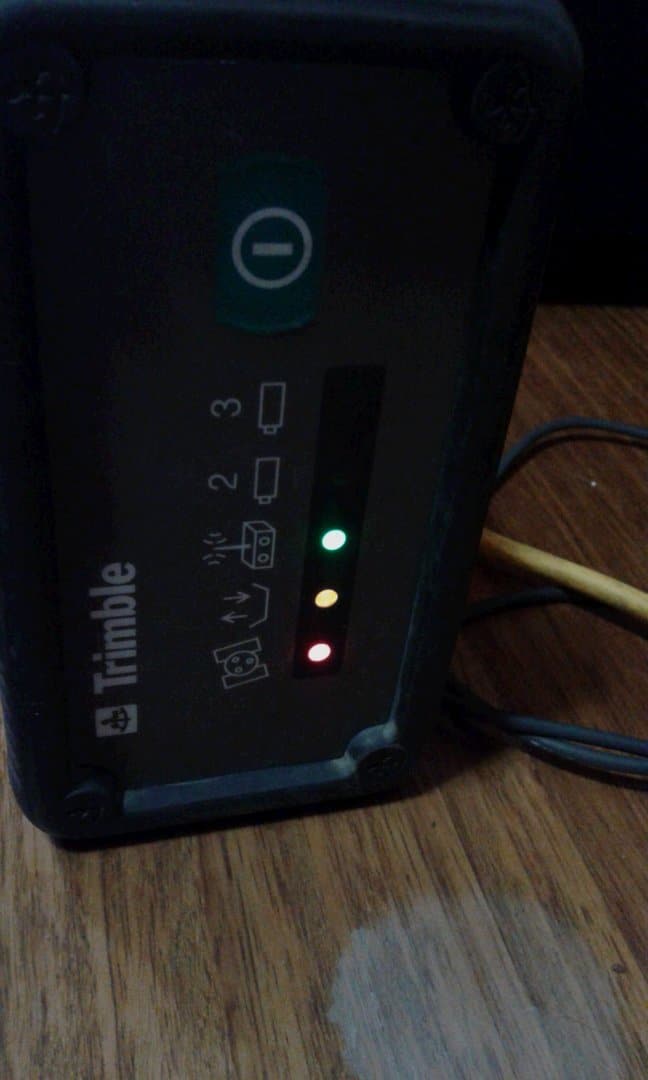

i got these problem...
https://surveyorconnect.com/community/attachments/gps-jpg.4322/?temp_hash=c2f84e532c978c6117b72acacc4dc834&apos ;">
Posted : May 18, 2016 10:54 am
I have a 4700 that won't log data; I wonder if resetting the file system will fix it. I'll see if the Configuration Toolbox thing will work.
Posted : May 18, 2016 2:27 pm

not...
recently lost a port 3(burning), i try to conect but all is bad...
repair port 3 (1 month waiting for lemo conector)
soon all is ok...
