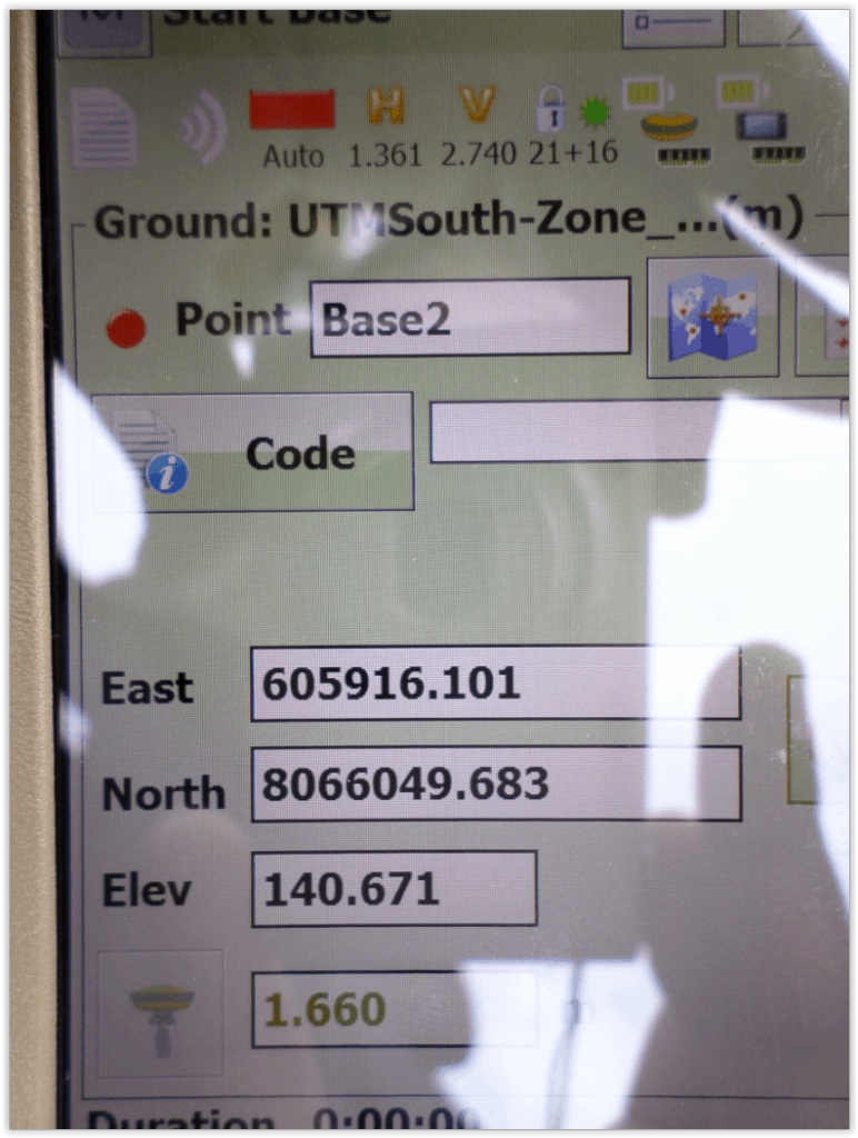

Hi All,
I'm using a Hiper V Topcon model and have been getting some issues with the radio signal strength of both the receiver and the base(the red light was blinking meaning the connection was low).
But the main issue today was that when I started the base to begin the survey the base did not come off of autonomous. Usually it would start at autonomous then go to float then fixed but today it just went on autonomous and never changed (the satellite coverage however was awesome!). This meant it didn't allow me to record gcp points as well, which was annoying. The accuracy for Horizontal and Vertical did not go any lower than 1 meter and this was odd as I'm used to seeing it closer to two decimal places.
Has anyone had or understands the issue here and how to fix it???
See picture attached as reference.
Thanks
Anare

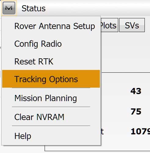

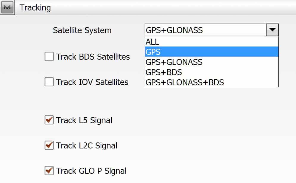

I don't think this a radio issue. I had similar problem yesterday with Hiper V's. Taking much longer than normal to go from Auto to Fix. I turned off Glonass, and instantly went to fixed. Turn Glonass back, and on my way. No problems rest of the day.
Not certain why. It just seemed to work. Have had to do this twice in past 10 days.

I'm a little confused by your post- you mention the base didn't fix. In a Base/Rover config the base never fixes. You set the base and the rover fixes. Only a corrected receiver can resolve to a fixed solution.Check the reference card regarding the lights for your radio. I think a quick review of that will answer that concern.

The base will never get a fix. Your post and your photo suggest you are connecting to a Topcon base using Magnet software. A fix will only be acquired at the rover.
Also it would help if we knew your location.
If it is a radio issue, you should use first use UHF scanner to check for an open radio frequency in your area.

pmoran, post: 328477, member: 8922 wrote: I'm a little confused by your post- you mention the base didn't fix. In a Base/Rover config the base never fixes. You set the base and the rover fixes. Only a corrected receiver can resolve to a fixed solution.Check the reference card regarding the lights for your radio. I think a quick review of that will answer that concern.
Sorry, you are correct. I meant the rover didnt get a fix...

anarefj, post: 328584, member: 9382 wrote: How exactly did you turn off the glonass satelites?
In Magnet Field go to SETUP >STATUS >Tracking Options
Click on pulldown for Satellite System and Select GPS only.

leegreen, post: 328591, member: 2332 wrote: In Magnet Field go to SETUP >STATUS >Tracking Options
Hi Lee. I'm actually out in the field as we speak and am attempting your option. Appreciate your assist!
Lee, is there a way to do that with TopSURV 8?
OK. I think I found it under Config: Advanced. I think...

Most here are quick to think these issues are caused by radio. I do think that is correct. Your GRS-1 is not using a UHR or SS radio, it uses a cell modem to connect. Most of the time my Hiper V's will connect with a fix in less than 1 minute, either via base/rover with UHF internal radios, or network connection with cell modem on controller.
When I see 100% radio, and autonomous for more than several minutes. I shutoff the GLONASS and most often get a fix instantly.

I'm not sure if this is what our guys are still doing, but in the past when it looks like the radio (cell or otherwise) is locked at 100% but it remains autonomous, we have hit "Reset RTK" and that usually fixes right away after that.
