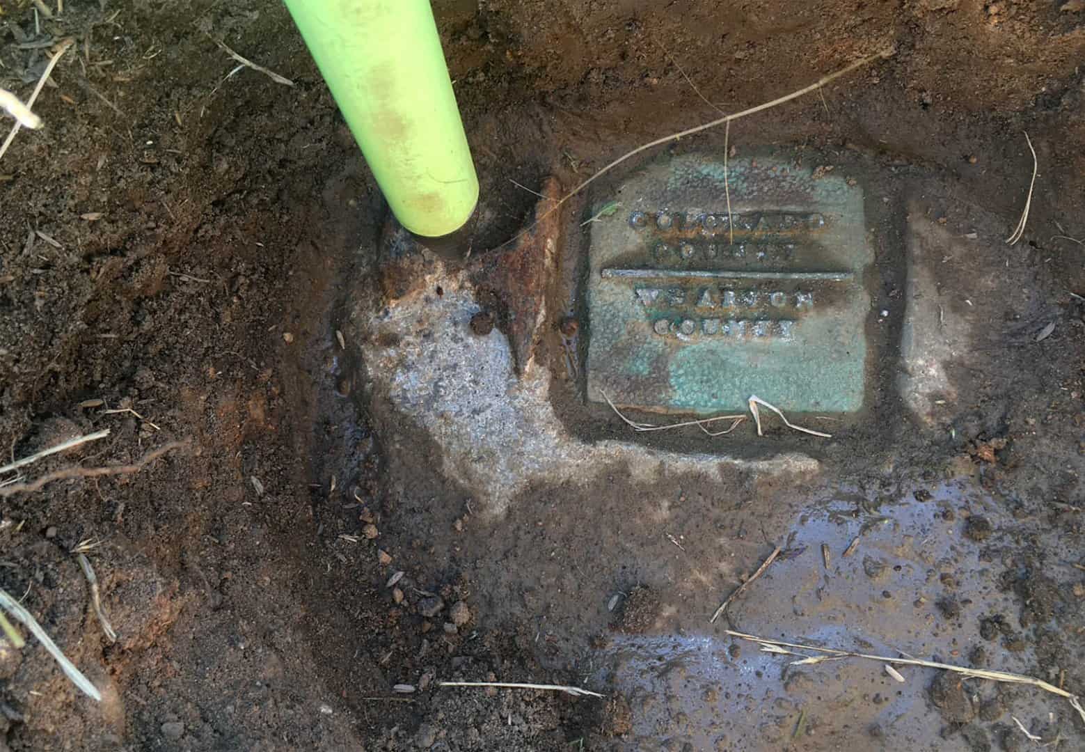

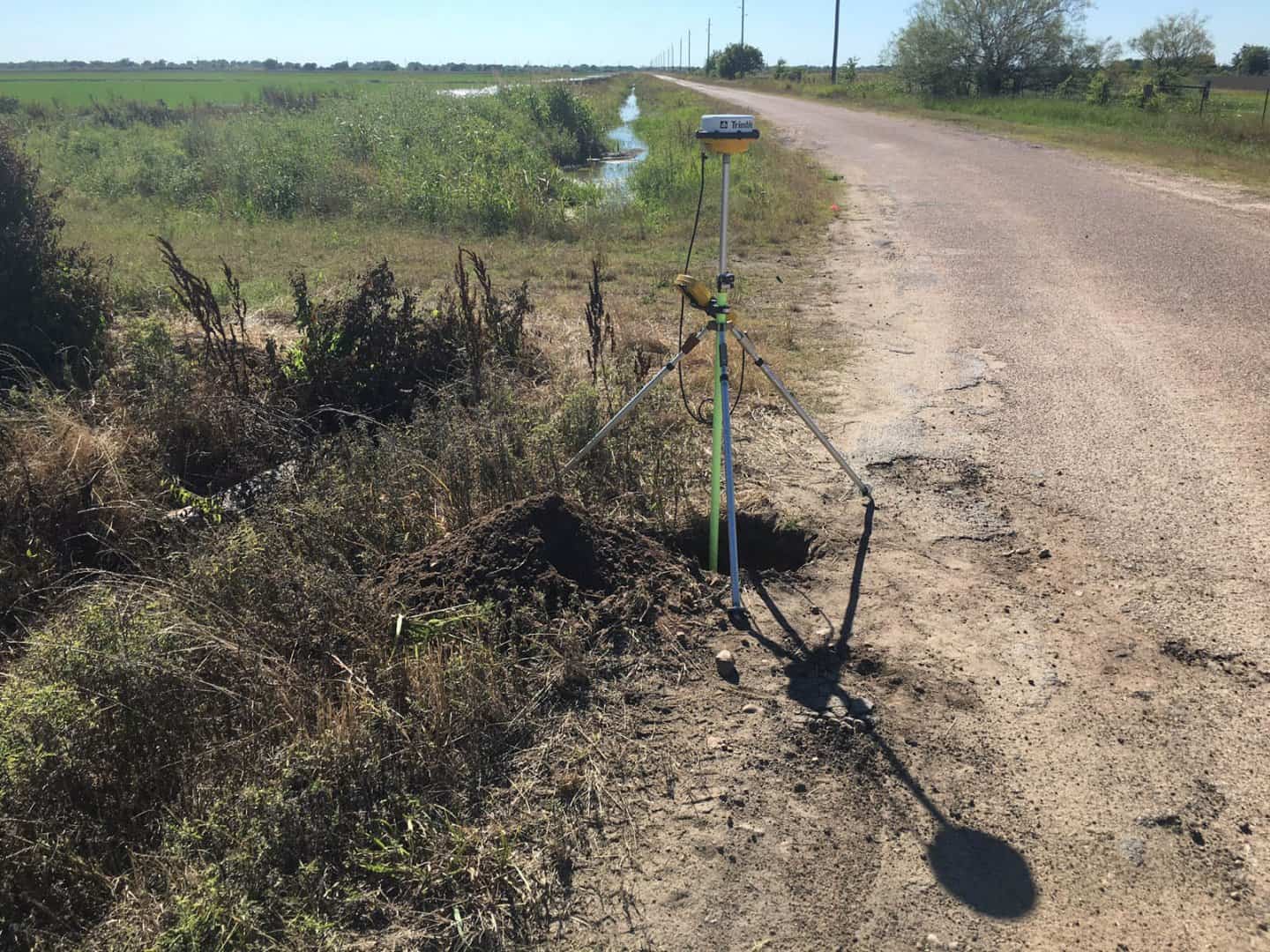

I spent the afternoon digging by the side of a county road passing through rice farms. I knew what I was looking for: a length of railroad rail that had been driven into the ground at some time before April 17, 1882 to mark a particular corner of a land grant made by the State of Texas to a railroad company in 1873.
Ever the optimist, I had previously scouted the vicinity of the corner, or at least where I had thought it might be based upon various clues in aerial photos. The 1882 surveyor had described the thing as "a Post of Railroad Iron". That sounded like something obvious, sticking well above grade, a post. The easy way didn't go very far, so this morning was spent locating other corners more than a mile distant from where the rail ought to be to then calculate from them where I might yet find the rail.
That involved first digging out the stump of a broken fence post on the theory that perhaps it had replaced the railroad iron, which I knew existed as recently as 1950. I thought the odds were still in favor of it remaining, but it wasn't exactly looking at me and one possible scenario was that the "post" had been replaced with something else, hence the investigation of the stump of the fence post.

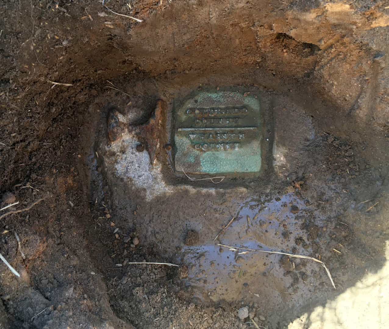

Digging out the broken post turned out to be just for practice because after spending a good bit more time chopping through the road base at the edge of a public road, the rail appeared, 15 inches under the surface. There wasn't much doubt about it, either, since a surveyor had left a magnificent cast bronze tablet identifying the thing, probably in about 1951, and it was now set in concrete for posterity.

Oh, where on the rail was the corner? I used the center of the cross-section, which fell on the web of the rail, midway between the top of the rail and the bottom of the foot.

Did you place a dimple there?
I would have.

The rail is more than 135 years old and I didn't particularly want to discover how deep the rust went by giving the web a smart rap with a center punch. The web was more eroded than the foot or top of the the rail, which suggested heavy corrosion. The "dimple" is the reference monument I set about 15 ft. away from the rail.

Kent McMillan, post: 429841, member: 3 wrote: I thought the odds were still in favor of it remaining, but it wasn't exactly looking at me and one possible scenario was that the "post" had been replaced with something else, hence the investigation of the stump of the fence post.
What did Mr. Schonstedt say about it? That chunk of iron, if of any significant length should have screamed.

Bill93, post: 429858, member: 87 wrote: What did Mr. Schonstedt say about it? That chunk of iron, if of any significant length should have screamed.
The magnetic signal was not as strong as I was expecting. The 1950 surveyor who evidently set the thing in concrete with the bronze plaque used a ferrous something as the form for the edge of the concrete and that may well have altered the field enough to matter.

The recovery 67 years ago was helpful in confirming that the thing was in place at that time and I would expect that the County Surveyor who did the work probably had more detailed records that would have helped locate the thing. They just didn't make their way to the GLO as they should have and what did was fairly unhelpful in that the nearest tie was to a stone miles away.
As for road development, I'm pretty sure that the road was built after 1950. So the marker survived that and the construction of various nearby canals against all ordinary odds.

Kent McMillan, post: 429870, member: 3 wrote: As for road development, I'm pretty sure that the road was built after 1950. So the marker survived that and the construction of various nearby canals against all ordinary odds.
Could it be that the marker was cut down in 1950, that what remains is a stub of the original? Or possibly driven or dug out and reburied at a depth that conformed to the road base? I suppose that is unknowable.
Posted : May 25, 2017 7:26 am
Forgot to add that a RR iron like that is very difficult to destroy or remove by grading etc
Usually only a backhoe will destroy the monument.
Posted : May 25, 2017 7:36 am
Mark Mayer, post: 429873, member: 424 wrote: Could it be that the marker was cut down in 1950, that what remains is a stub of the original? Or possibly driven or dug out and reburied at a depth that conformed to the road base? I suppose that is unknowable.
I think that's a reasonable conclusion since it simply is isn't plausible that what was described as a "Post of Railroad Iron" in 1882 wasn't sticking up well above grade on treeless prairie. However, I strongly doubt that the rail was other than something like a cut end of a rail much shorter than a full length. I'll have to take a look at aerial photos from 1952 again to see whether I'm mistaken as to whether the road was in place then or not.

Most descriptions in these parts call for "rail end" when referring to RR rails.
They come in a variety of sizes from small gauge rail to some rather heavy duty full sized rail.
The one in the picture appears to be small gauge and has rusting away in the middle of all that fertilized farming ground.
