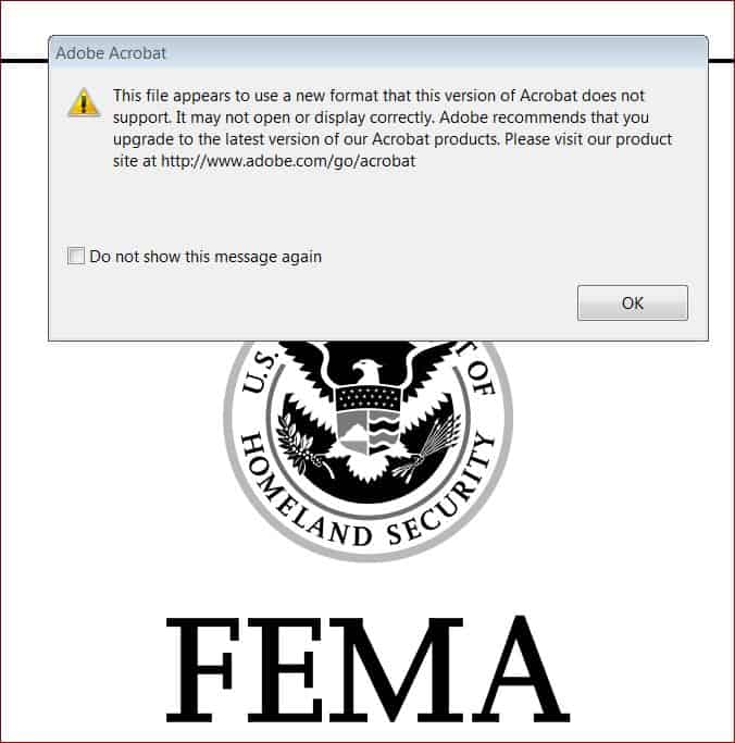

I received a copy of the new EC, but when I open it, a message appears saying that my version (Acrobat Standard 9.5) is too old and some features might not work. Great, more money! What version do I need, 11?
I can enter text, but I still can't figure out how to put a picture in. Can anyone help?

My Acrobat XI Pro would not open the form, I got this message splashed on the screen
Please wait...
If this message is not eventually replaced by the proper contents of the document, your PDF
viewer may not be able to display this type of document.
:-S
Posted : January 8, 2016 12:04 pm

A Harris, post: 352332, member: 81 wrote: My Acrobat XI Pro would not open the form, I got this message splashed on the screen
Please wait...
:-S
Same here.
Ed
Posted : January 8, 2016 12:09 pm
Opens for me in Adobe Acrobat 9.2 with an 'update recommendation'.
DDSM:beer:
Posted : January 8, 2016 1:35 pm

Tyler Parsons, post: 352328, member: 139 wrote: I received a copy of the new EC, but when I open it, a message appears saying that my version (Acrobat Standard 9.5) is too old and some features might not work. Great, more money! What version do I need, 11?
They've created this form with Adobe Live Cycle and Acrobat Pro is incapable of editing anything in it. Filling in the blanks is the best you can do. Unfortunately the section for the photos was created as a text box which will not allow the insertion of an image.
Here's how you beat it into submission: Fill out the form then select print and choose [hl]Adobe PDF[/hl] as your printer. The resulting pdf will be flat (no fields) and you can go to [hl]Tools, Content Editing, Add Image[/hl], then insert images on the photo pages and text boxes for descriptions of the photos as needed. When finished, you can print to the [hl]Adobe PDF[/hl] printer again if you want to have a non-editable pdf to distribute or just send it to your regular printer for a hard copy.
Edit: The above works with Acrobat XI pro, similar workarounds will likely work with older versions.
Posted : January 8, 2016 1:36 pm
tyler-parsons
(@tyler-parsons)
Posts: 554
Thanks Stephen,
I have Acrobat 9. I followed your example but did not find Content Editing. I printed to Adobe PDF, then Tools, Comment & Markup, Paste Clipboard Image as a Stamp Tool. This works in the Stamp block too. Still, we should not have to do this.
I shot a reply back to my County Flood Plain Coordinator noting the opening errors and the picture problems, and asked that she pass the information up the line. I also asked for a Word/Office version.
If enough of us do this, perhaps someone will listen and fix the problem - or at least make a reasonable work-around.
