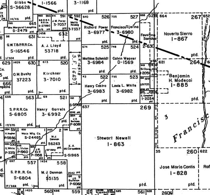

These two maps represent my current favorite example of the giant traps awaiting any surveyor who wants to have complete confidence in the compilations of original survey lines represented in the Texas Railroad Commission GIS. The first image below is a detail taken from the official County Map for Dimmit County dated 1976 compiled in the GLO. This is the same map that the Texas RRC GIS was basically traced from.
Note the mysterious white space with a couple of file numbers on it between the Kirchner and Henry Castro surveys and the A.J. Lloyd and Mathias Schmidt surveys, as well as the double-headed arrow indicating that the lines at either end of the two arrows are in fact adjacent and not hundreds of varas apart.
This map was, of course, compiled forty years ago by a GLO draftsman from the field notes of the various surveys shown that are on file in the GLO, as well as from earlier versions of the Official County Map that had done the same.
However, what the compiling draftsman neglected to discover was that two entire patented surveys were omitted in the earlier county map. The field notes of those surveys are on file in the GLO as you only discover when you start actually examining the field notes of the various surveys that are shown upon the map.

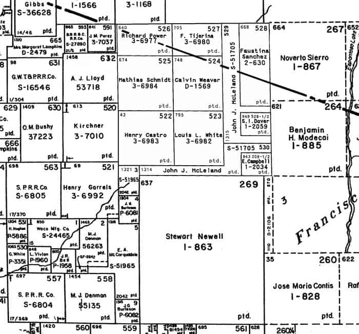

This is what the Official County Map would really look like if properly drawn. Looks a bit different, eh? Well guess which is reflected by the RR Commission GIS and probably will be for the foreseeable future?

Kent McMillan, post: 379386, member: 3 wrote: However, what the compiling draftsman neglected to discover was that two entire patented surveys were omitted in the earlier county map. The field notes of those surveys are on file in the GLO as you only discover when you start actually examining the field notes of the various surveys that are shown upon the map.
Actually, to be more correct, I should have pointed out that the GLO County Map does note file no. Bex-S-51705, which is the file that contains the field notes of the two McLeland surveys upon which patents issued. So, in that sense, the surveys aren't missing completely. However, the compiling draftsman failed to plot the field notes of the surveys in an way that resembles what the GLO records disclose as correct; so they are nearly invisible on the County Map and completely so in the GIS product.
