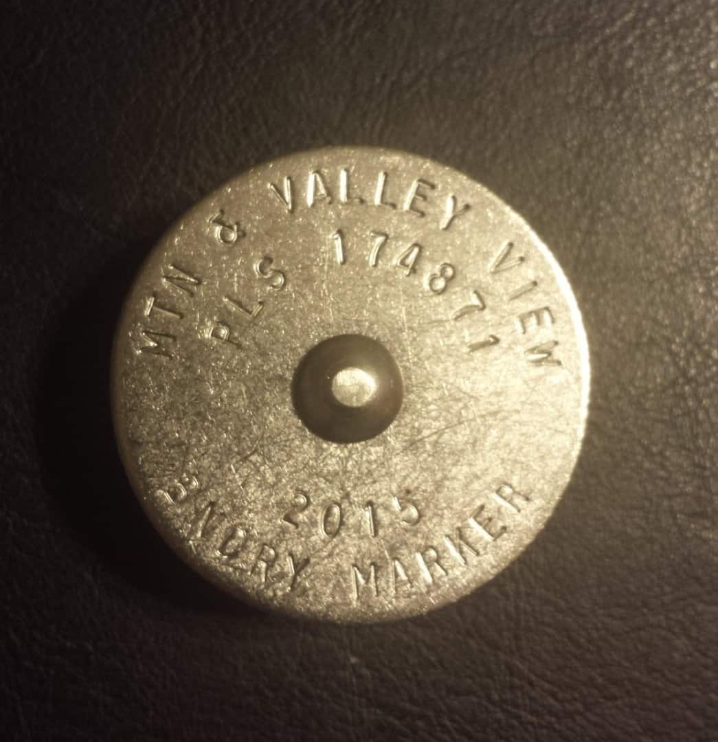

I working on a survey marker system. I'm looking for something sort of simple yet very attractive, durable and lasting. My first prototype is to use a washer that has been stamped and attach it thru the center with a drive screw. It could be attached to a rebar or pipe or even a concrete imbed.
I've had some stainless steel washers stamped for a current project. Here is a couple of pictures of a stack of the washers with a drive screw set in. This is how it would look once installed on a bar or pipe.
Installation would be about the same as placing a standard cap. The rebar (or pipe) would be driven in the ground (or hole dug and buried). Then you'd simply put the washer on top and pound the drive screw in tight. It would be a pretty permanent attachment.
I'm looking to see if there would be any interest in this system, whether I could sell them to land surveyors. I think the cost would be very competitive with other metal markers. They could be made of aluminum or brass but I think the stainless washer and drive screw would work the best. I'd market the washers, rebar, pipes, and imbeds as a complete marker system.
Any comments would be appreciated!

LRDay, post: 334084, member: 571 wrote: attach it thru the center with a drive screw. It could be attached to a rebar
For this to work with rebar you'd have to drill a hole in the top. If you predrill it, the hole is liable to get so badly deformed during driving that the pin/rivet/screw won't fit. If you attach the washer before driving, the washer is likely to get illegibly mashed. And if you don't predrill it, the field guy will have to carry a drill and try to put a hole into the top of a work-hardened rebar -- good luck with that.
I guess I don't understand how this will work with rebar.

Jim Frame, post: 334115, member: 10 wrote: For this to work with rebar you'd have to drill a hole in the top. If you predrill it, the hole is liable to get so badly deformed during driving that the pin/rivet/screw won't fit. If you attach the washer before driving, the washer is likely to get illegibly mashed. And if you don't predrill it, the field guy will have to carry a drill and try to put a hole into the top of a work-hardened rebar -- good luck with that.
I've thought about that and think I have a solution but only testing will confirm. I should be doing that the next month or so. I will weld a short piece of mild steel onto a weldable deformed bar and then pre drill it. The welded on"head" will be larger than the rebar in diameter and then a driving tool used so that the hole isn't damaged. The head could be up to 2" in diameter to match the washers if I wanted it to be. I'll probably try something maybe 1-1/4 in diameter to start.

LRDay, post: 334143, member: 571 wrote: I will weld a short piece of mild steel onto a weldable deformed bar and then pre drill it.
What sort of price point are you aiming at with this product? It's starting to sound really expensive. Is there really a market for this animal, given that common pipe and rebar are in such widespread use and acceptance by the surveying community?

Jim Frame, post: 334148, member: 10 wrote: What sort of price point are you aiming at with this product? It's starting to sound really expensive. Is there really a market for this animal, given that common pipe and rebar are in such widespread use and acceptance by the surveying community?
The washers are economical. The rebar will cost more. I believe that the whole "monument" will be competitive. Part of the reason for this posting is to start to get some information from working surveyors. I've always leaned to a high quality marker which costs a little more. It never made sense to me for a landowner to pay thousands for a survey and then get a few two-bit non durable plastic markers, but that seems to be the norm.
Surveyors, does this look like a nice durable marker or not? If the cost is relatively competitive would you consider using it?

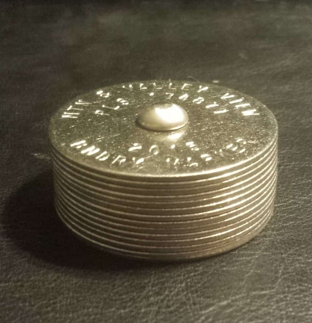

What purpose do the multiple stacked washers serve?
I like the idea of a durable stamped washer. Surveyors around California have been using brass tags for a long time.
You will see them nailed to a bearing tree, in the top of a fence post, set with a lead and tack in concrete, tied to a pipe with copper wire, ect. I think I have even seen them set in the top of rebar. Most common was a tag/tack into a wooden peg in the center of an iron pipe (which typically fall out).

imaudigger, post: 334382, member: 7286 wrote: What purpose do the multiple stacked washers serve?
I did the stack to show the drive screw inserted for the picture. One stamped washer is all that is needed unless you wanted the beef it up.

I think freeze/thaw would pop them off here.
I like the plastic caps that are are NOT deformed (Morasse caps) if someone tries to move them.

Jim in AZ, post: 334392, member: 249 wrote: I think freeze/thaw would pop them off here.
I'll test them to see how hard they are to pull out. I think if the rebar head or pipe diameter was as large as the washer that freeze wouldn't disturb the washer. Maybe a dose of silicone or epoxy between the washer and the head would keep water out. I expect the washer would deform before the drive screw came loose. Could go to a larger drive screw if needed.
