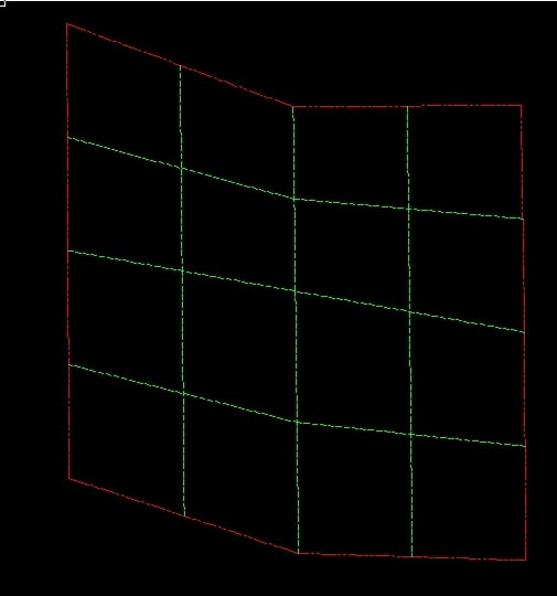

Which Book?
"Section 3-3
(5) The subdivision of the townships into 36 sections by running parallel lines through the township from south to north and from east to west at distances of one mile. The sections are numbered commencing with number 1 in the northeast section of the township, proceeding thence west to section 6, thence south to section 7, thence east to section 12, and so on, alternately, to number 36 in the southeast section."
The upper sketch shows the use of parallel lines.
"3-75. Under the rectangular system the unit of survey is the township of 36 sections. The unit of subdivision is the section of 640 acres. Under the general land laws, broadly, the unit of administration is the quarterquarter section of 40 acres."
Again the upper sketch fulfills the proper subdivision, with the probability of 4 40s in each quarter. The PLSS is an "Equal Area" method, not a "Straight Line" method.
"Partial Irregularity
3-64. Where the south part of the east boundary, or the east part of the south boundary, is regular, and the balance is defective in alinement and not subject to rectification, the subdivisional survey is made regular as far as possible."
This is in fact what the upper sketch does.
Not all Townships are regular and not all sections are regular, the majority of the rules applies only to Regular Townships and Sections.
Paul in non PLSS PA
Posted : January 5, 2016 2:52 pm

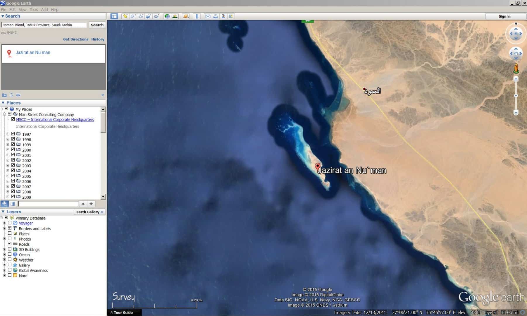

MightyMoe, post: 351794, member: 700 wrote: "no man is an island"
I wonder if anyone has ever named an island Noman.
Posted : January 5, 2016 3:35 pm

Might Moe,
An irregular section, they used the wrong method to set the center but after that a correct method was used to subdivide for the 40s.
Oh well.
Posted : January 5, 2016 4:28 pm
