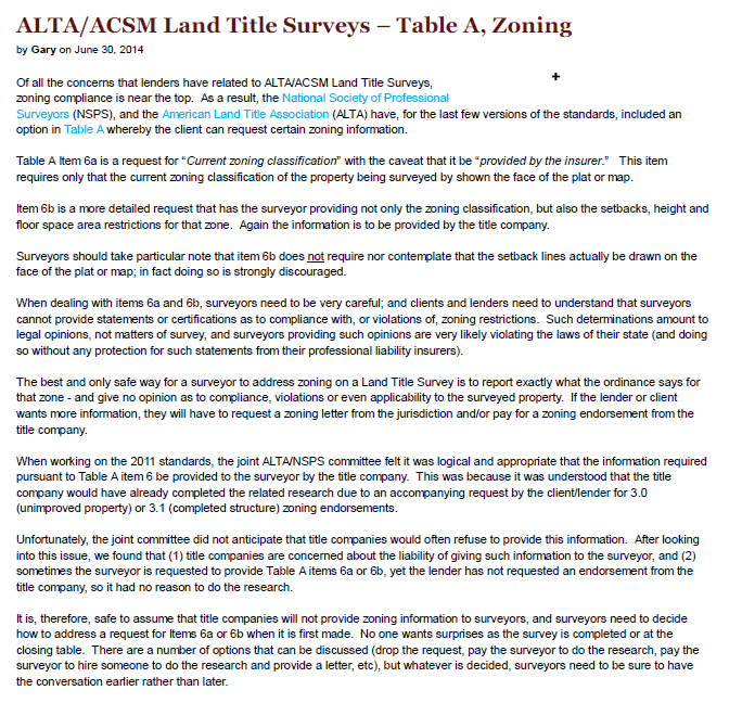

Here's another way to consider the issue:
Let's say you make a zoning determination for your client and, as an advocate for your client, you make a call that suits their needs.
Now things go sideways.
How do you want to open the discussion when you get the call from their Attorney.
Pick one:
1) I read the section of the zoning manual regarding setbacks and showed them on the plat based on my interpretation of the manual.
2) I have scanned and emailed to your office a copy of a letter dated 4/25/17 and signed by D.J. Opinion, from the Shucks County Planning Department, stating the opinion of the zoning department. These are the setbacks shown and the letter referenced on my plat.

Dug this up too, by Gary Kent.

Here is my point precisely.
If that first opinion were in writing, even if it were incorrect, you'd be in the clear. Furthermore, the client will have a STRONG case to bring to a board of adjustment if need be.
THIS is serving your client!
