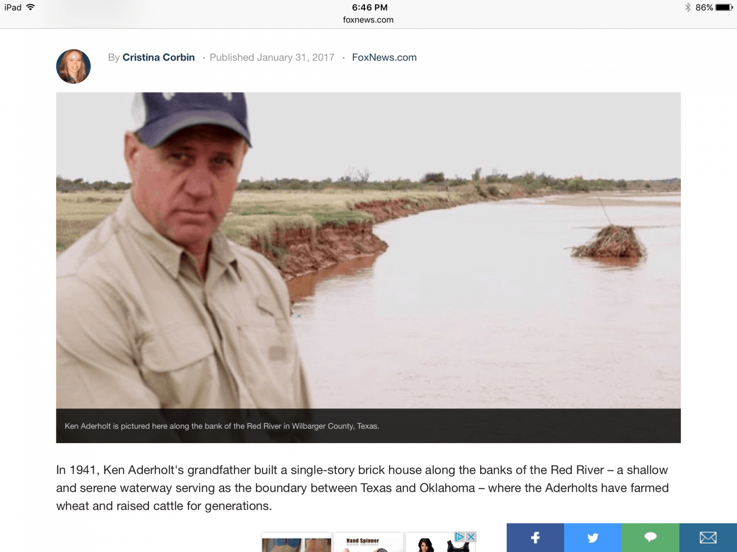

Kent McMillan, post: 412504, member: 3 wrote: I don't make a practice of posting links to this source, but it does capture the misunderstanding as to what the decision in the 1923 case of Oklahoma v. Texas as to the south bank of the Red River really means to the rural folks in North Texas who own land along the Red River thinking that they really own more than they do. History is hard, apparently even for ambulance-chasing lawyers who say things like this:
The U.S. Supreme court case is clear in that it established the boundary of federal territory at the south bank of the Red River," Henneke said. "Beyond that is my clients' private property and it is outrageous for the government to suggest they should have to buy back what they already own."
http://www.foxnews.com/us/2017/01/31/texas-landowners-fight-federal-government-over-red-river-land-grab.html
So I guess what they show is not the riverbank per the gradient method?
Posted : February 5, 2017 8:48 pm
Dave Karoly, post: 412591, member: 94 wrote: So I guess what they show is not the riverbank per the gradient method?
That doesn't look like an accretion bank with a back drain on the side away from the river, so I don't think that it would not be considered one of the key banks from which the gradient boundary height would be determined.
Posted : February 5, 2017 9:07 pm
"so I don't think that it would be considered one of the key banks"
Posted : February 5, 2017 9:24 pm
