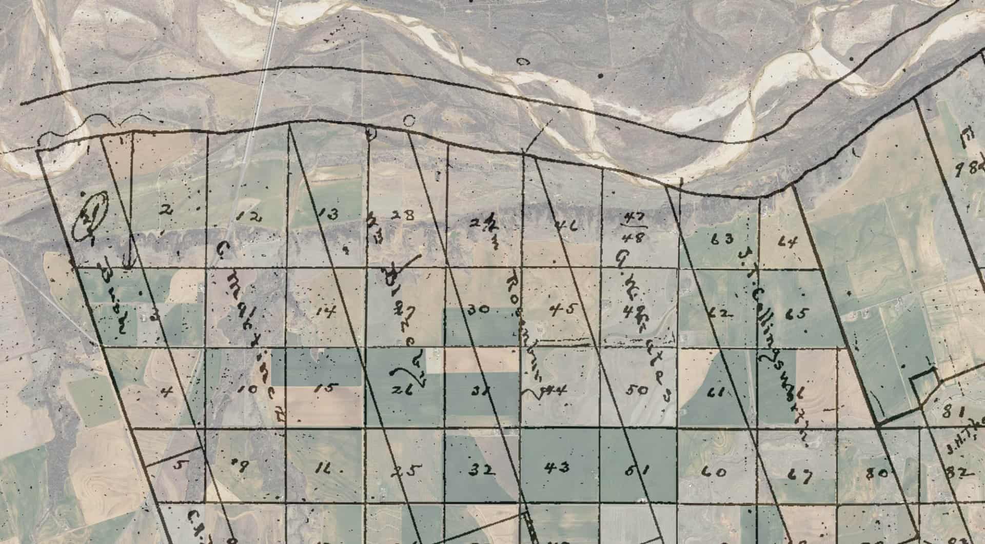

Here is that 1905 map of the agricultural subdivision known as WAGGONER COLONY (a resubdivision of various original land grants) overlaid on a current aerial. Some of the 160 acre "sections" of WAGGONER COLONY as platted do appear to have originally extended well out into the channel of the Red River. There was a Charlie M. Aderholt who in 1942 was conveyed the tract designated as Section 47/48 on the map of WAGGONER COLONY that appears to now have a house on it on the top of the Texas bluff on the Red River that may be the land that Ken Aderholt described as that his grandfather built a house on in the early 1940s.
Posted : February 6, 2017 8:19 am
And here's what I think is "Section 47/48" of WAGGONER COLONY that in 1942 was conveyed to Charlie M. Aderholt (and the land lying North of the gradient boundary along the South bank of the Red River):
Posted : February 6, 2017 8:33 am
