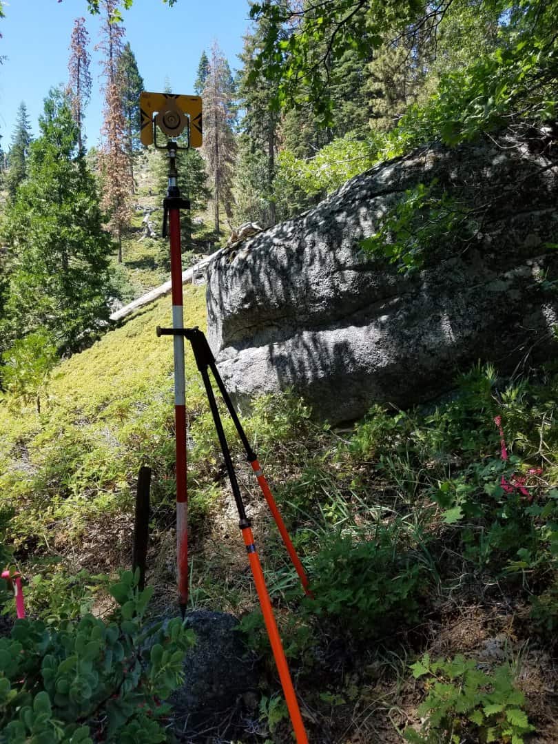

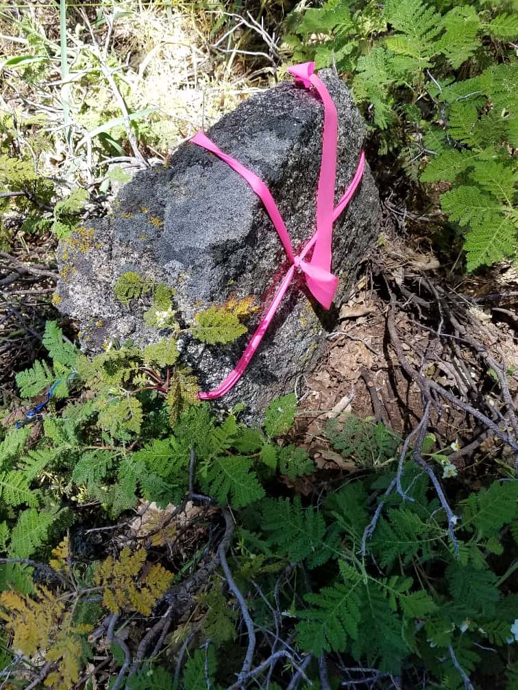

I calculated the location of this corner by combining different sources of record information and a single proportion on where the section corners were located and walk right up to it with my iPhone navigating. Dan wrapped it with flagging before I took photos. 24x18x3 in granite stone, measures 12" up, 14"x3" in stone mound. One BT down and almost rotted away, one standing with aluminum tag. 1878, P.Y. Baker. Can't see a 1/4. The east quarter BLM says has 1/4 on southeast face. This stone is oriented with big faces NW & SE. This is at 6100 MSL in Mountain Home Demonstration State Forest...

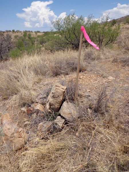

Found this in Nogales, AZ near US Mexico border...the orientation aligned with other stones he set in the vicinity

rlshound, post: 434383, member: 6800 wrote: Found this in Nogales, AZ near US Mexico border...the orientation aligned with other stones he set in the vicinity
Obviously, it is the correct stone. I mean the surveyor left a lath to monument it.

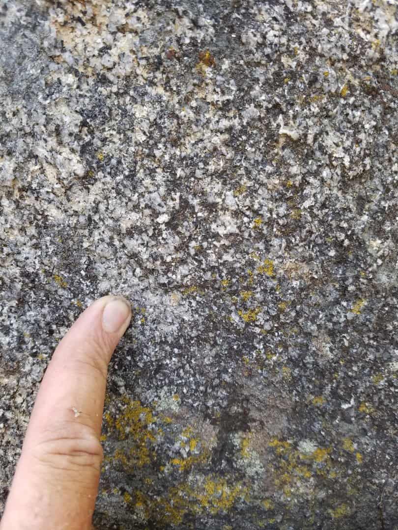

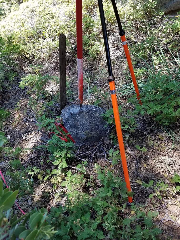

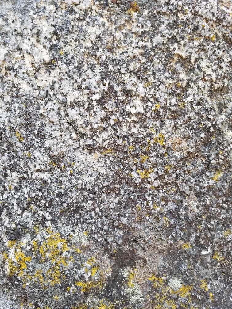

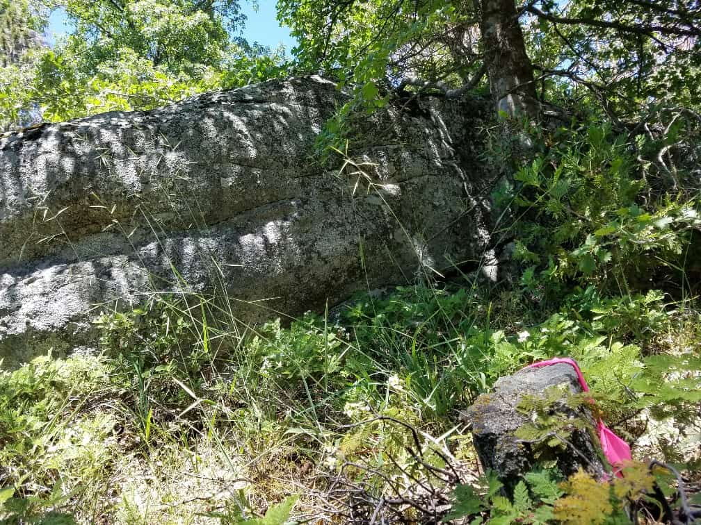

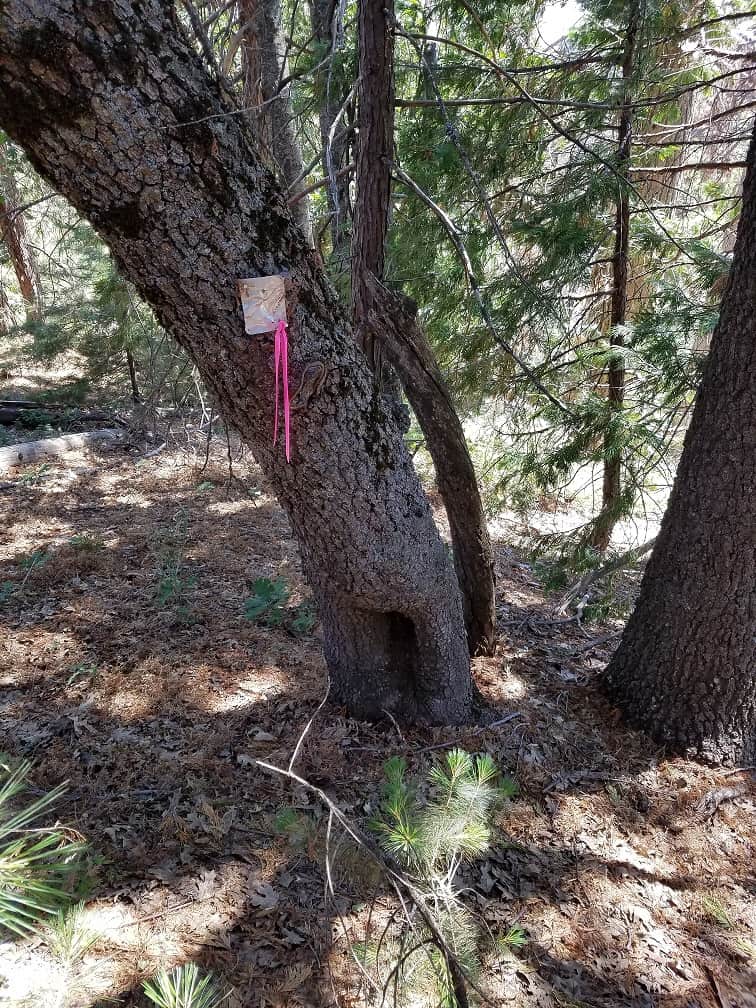

I got better photos...Garrett found a very weathered and faint open 4 on the southeast face. There is a grape stake found on the ground with a scribed 1/4 on it...2x2 Redwood, not original. Large partially open blaze on black oak BT. Will post photos later (too big to post from phone).

Jack Chiles, post: 434652, member: 24 wrote: Obviously, it is the correct stone. I mean the surveyor left a lath to monument it.
According to the field notes would be a clue...I think your suffering from Survey Connectitis, maybe you could take some of your own medicine and get sicker, ya that's the ticket!

I took more photos of the stone and bearing tree:
The stone:
Garrett found the 4 on the stone, taking copious notes here:

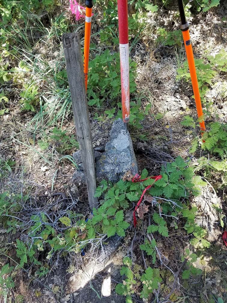

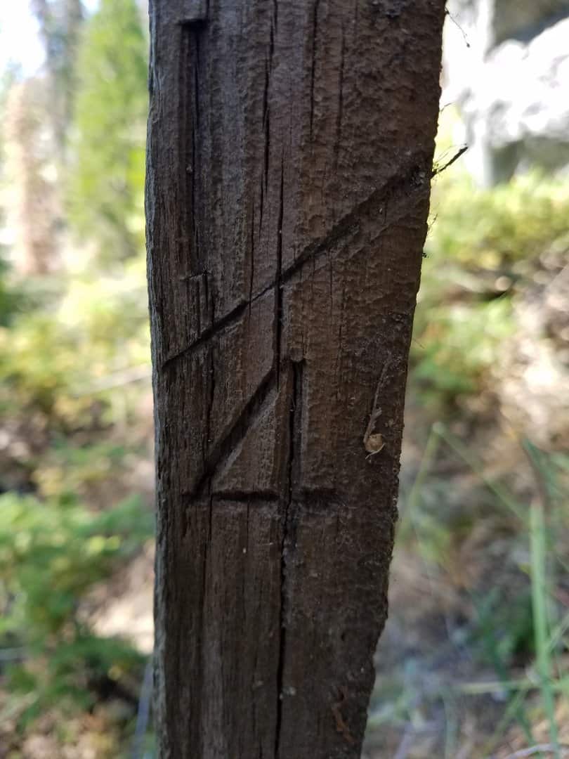

Close-up of the 1/4 on a 2x2x3' long redwood stake found on the ground:
Garrett found a heavily weathered open 4 on the stone (1878). No 1 or the line under it is visible:
My finger is pointing to the left corner of the open 4:

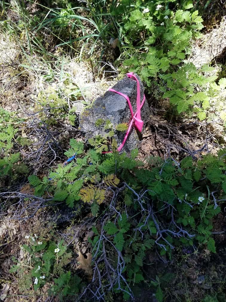

Another photo of the stone:
The stone with the stake next to it:
Original black oak bearing tree, large face at the bottom:
