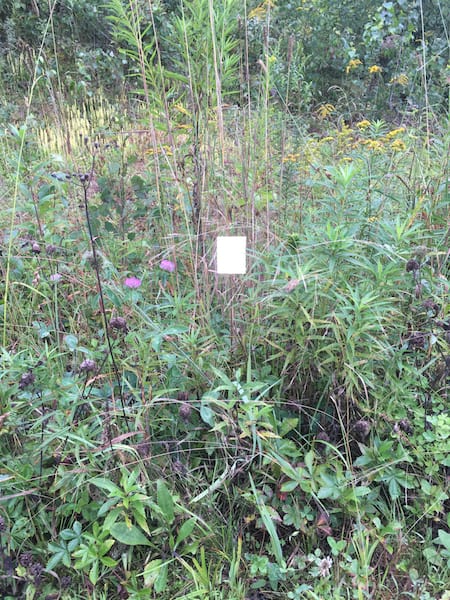

Well, it's not even Friday, but I'm thinking ahead to a glorious late summer weekend, and thought the team here could use a good chuckle. But keep it down if you will please.
Keep in mind: Solo operator (wife, a.k.a. "Prism Girl" now works on weekends). Phase I of control network 90% complete except for a few do-overs; ready to do topo.
I tried my Seco prism tripod previously, but it was like watching paint dry (although I got a great deal of exercise walking God's great earth.)
So now, I'm thinking of using these:
https://www.amazon.com/dp/B01AOUWDLE/ref=sxr_pa_click_within_right_4?pf_rd_m=ATVPDKIKX0DER&pf_rd_p=2329824862&pf_rd_r=ZZNSEQVP0P81G9K0M03T&pd_rd_wg=8fVKb&pf_rd_s=desktop-rhs-carousels&pf_rd_t=301&pd_rd_w=aMO0o&pf_rd_i=plant+label+sticks&pd_rd_r=ZHTXT1ERV1ZT4JQX5NA1&psc=1
I have a roll of 2" wide reflector tape, which I'd cut into 1" pieces and stick to the "flags", similar to something like those I read here that the guys use for highway shots, minimizing time in the road. This is mainly dirt and grass, so I need something I can stick into the ground.
I'd walk around and plant 50 at a time or so, then go back to the instrument and shoot away; then go pick them up and do the next area.
ps: Obviously, budget on this project is not an issue, for those that haven't gotten that I don't do this for a living.
Thoughts?

I've done it too.
Accordion fold duct tape, stuck to C/L with DOT tape stuck to it.
small pebble with taped to C/L, with DOT tape stuck to it.
1" x 1" x 4' hardwood stakes, set in grassy field, with DOT tape on top. Shoot from one side, to the other, radially, to keep from skipping one. Setting about 15-20 at a time.
Small dot of paint on trees, with DOT tape.
Just to fuel you ideas. I've done it too.

rfc, post: 386780, member: 8882 wrote: So now, I'm thinking of using these:
Sounds like a good idea, but I worry those particular stakes you linked might not be tall enough for anywhere but a closely mowed lawn.
Posted : August 17, 2016 2:37 pm
Bill93, post: 386859, member: 87 wrote: Sounds like a good idea, but I worry those particular stakes you linked might not be tall enough for anywhere but a closely mowed lawn.
You might be right...I was thinking of doing the open areas/fields/drive/ditches etc. first. Go lots of deciduous canopy with nothing but leaves on the ground. They'll work there too. But when i get to the raspberry patches....hmmm...I'll have to come up with something else. (I love the goat idea!)

If I tried JaRo's idea, the damn goat would lay down for a nap. take pin flags with an 18" wire, paint the bottom 6" of the wire a bright color. Stick the pin flags wherever you want shots, 6" deep (til the paint is covered) and reflectorless to the flag. use a 1' high target height, and you are good to go for topo. (if you don't need tight tolerances)
Posted : August 17, 2016 6:40 pm
Monte, post: 386911, member: 11913 wrote: If I tried JaRo's idea, the damn goat would lay down for a nap. take pin flags with an 18" wire, paint the bottom 6" of the wire a bright color. Stick the pin flags wherever you want shots, 6" deep (til the paint is covered) and reflectorless to the flag. use a 1' high target height, and you are good to go for topo. (if you don't need tight tolerances)
Thanks for the idea Monte; but you may have missed the humor in "reflectorless" being in quotes. My instrument is not reflectorless (or robotic). I do like the idea of trying to use pin flags, perhaps with DOT tape put on the flags. Lot easier to stick in the ground than the little plastic garden tags, and (as Bill93 appropriately points out), taller grass and weeds wouldn't be as much as a problem.

I used to do the same thing with 3 foot or 4 foot wooden stakes. Put the reflective tape at the top, put a mark at the bottom of the stake and pound each stake in to the mark. From the mark at the bottom to the center of the reflective tape is the hr, use that and topo away.

That thing looks like it'd cost more than a robotic total station! It'd be totally fun to use though. I think these things are going to work great though:
And I already have hundreds of the pin flags.
