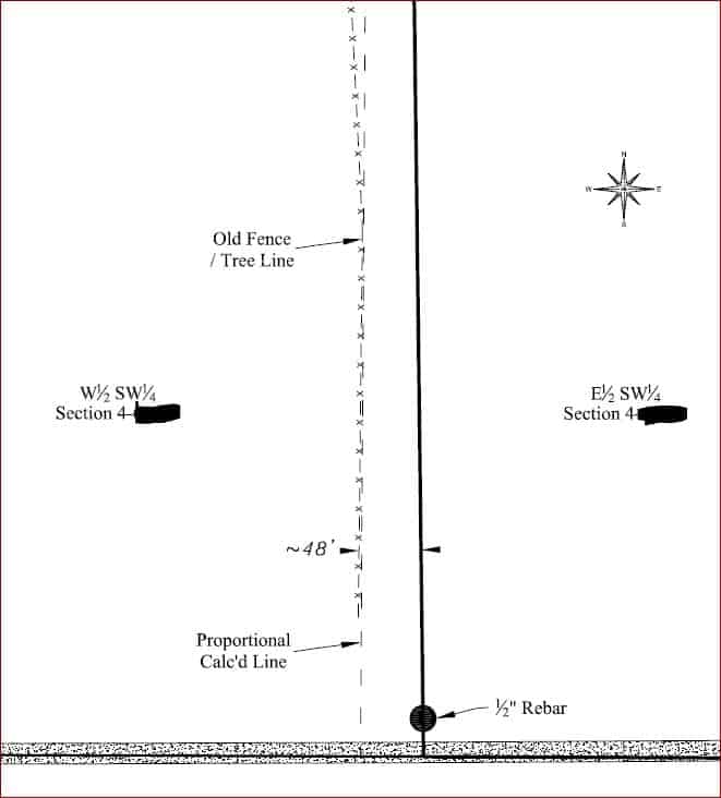

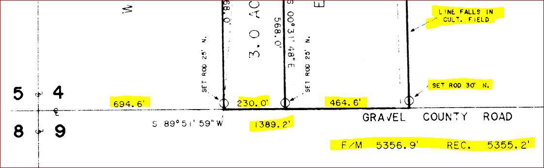

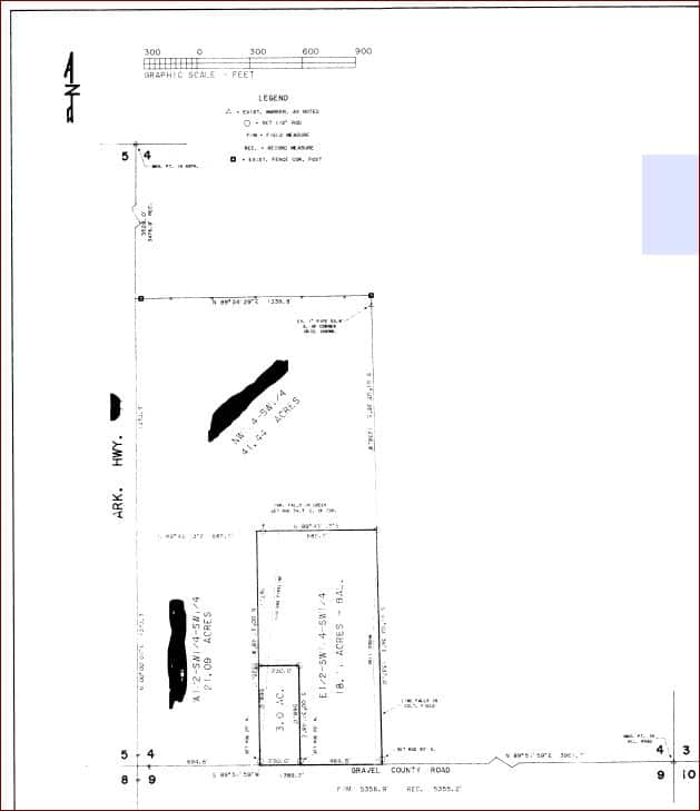

Fellows,
We have discussed ‰Û÷following in the footsteps‰Ûª, retracement surveying, and locating the ‰Û÷established‰Ûª boundary. What do we advise a young surveyor to do when they run into a previous surveyor‰Ûªs blunder?
Not a question of tools or technology, but of following in the footsteps ‰Û÷without stepping on toes‰Ûª.
The clip of a recorded plat is dated 2007 (information redacted to protect the ‰Û÷old‰Ûª surveyor). The clip of ‰ÛÏsketch‰Û is dated‰Û?errr‰Û?yesterday and was presented to the ‰Û÷old‰Ûª surveyor for comment.
Do you HOLD or FOLD?
DDSM:-S
2007 Plat
Close up...note the dimensions...do you see the 50 foot blunder?
2016 Retracement sketch
Posted : March 24, 2016 1:40 pm

That's a good one. If I understand it correctly, even the older survey shows a fence substantially in the correct proportioned location?
Posted : March 24, 2016 2:11 pm
Tom Adams, post: 364007, member: 7285 wrote: That's a good one. If I understand it correctly, even the older survey shows a fence substantially in the correct proportioned location?
The 2007 plat notes a "woods line" (for the thin line to the west) and "line falls in CULT. FIELD" (for the heavy property line). There is no mention of any fence along the "woods line".
The 2016 retracement surveyor, questioning his next move, called the old surveyor and "went back out there after we talked and found an old fence mostly on the ground running northward through the woods".
DDSM
(See the last few posts at https://surveyorconnect.com/threads/gps-on-benchmarks.325906/page-2&apos ;">GPS ON BENCHMARKS to see how well Arkansas Surveyors communicate...LOL)
[USER=94]@Dave Karoly[/USER]: A BRAND NEW FENCE WAS BUILT ALONG THE 2007 SURVEY LINE.
What would you advise the young retracement surveyor to do??? HOLD or FOLD??
Posted : March 24, 2016 3:00 pm
Dan B. Robison, post: 364013, member: 34 wrote: The 2007 plat notes a "woods line" (for the thin line to the west) and "line falls in CULT. FIELD" (for the heavy property line). There is no mention of any fence along the "woods line".
DDSM
The 2007 Surveyor messed up. If the owners agreed to settle their uncertainty in 2007 and accepted the messed up line by building the fence then it may be too late to fix it.

Dave Karoly, post: 364047, member: 94 wrote: The 2007 Surveyor messed up. If the owners agreed to settle their uncertainty in 2007 and accepted the messed up line by building the fence then it may be too late to fix it.
Yes, and if so, the 2007 surveyor may ultimately end up "buying" the ground lost by the adjoiner. Sure hope he has insurance...............

Brian Allen, post: 364083, member: 1333 wrote: How about we find authoritative sources of the "rules" we tend to throw around.
Brian Allen, post: 364051, member: 1333 wrote: Yes, and if so, the 2007 surveyor may ultimately end up "buying" the ground lost by the adjoiner. Sure hope he has insurance...............
Arkansas Code Annotated å¤ 16-56-112 (2011) ....must commence any legal action based upon any defect in this survey within five years after you first discover such defect. In no event may any action based upon any defect in this survey be commenced more than five years from the date of the certification shown hereon....
When adjoining owners employ a surveyor to run the boundary between them not because they have had a dispute about it, but merely because they are ignorant of its exact location, such survey is not conclusive on the parties, even though they acquiesce in it believing it to be correct. Pickett v. Nelson, 79 Wis. 9, 47 N.W. 936
The owners of adjoining lands are not bound by an erroneous survey made at their request, without knowledge of the error. Wesley v. Sargent, 38 Maine 315.
Where adjoining owners, whose division line is susceptible of exact location, have a survey made, which is afterwards discovered to be erroneous, the fact that both parties, having no previous opinion as to the location of the line, express themselves as satisfied with the survey, and acquiesce therein for five years, does not estop either of them from insisting on the true boundary. Sanford v. McDonald, 53 Hun. 263, 6 N. Y. S. 613, 25 N. Y. St. 721.
Whether he was a professional or official surveyor, or represented himself as such, his undertaking was that he should bring to the work the necessary knowledge and skill to perform the same properly and correctly; and if he failed so to do, and the employer sustained damages in consequence of such failure, the plaintiff will be entitled to recover. Highway Coms. V. Beebe, 55 Mich. 137, 20 N.W. 826.
Yet a person undertaking to make a survey does not insure the correctness of his work, nor is absolute correctness the test of the amount of skill the law requires. Reasonable care, honesty and a reasonable amount of skill are all he is bound to bring to the discharge of his duties. 4 Ruling Case Law 77; Taft v. Rugherford, 66 Wash. 256, 119 Pac. 740.
[sarcasm]I figure it will be easier to have the survey crew move a half mile of fence...[/sarcasm]
