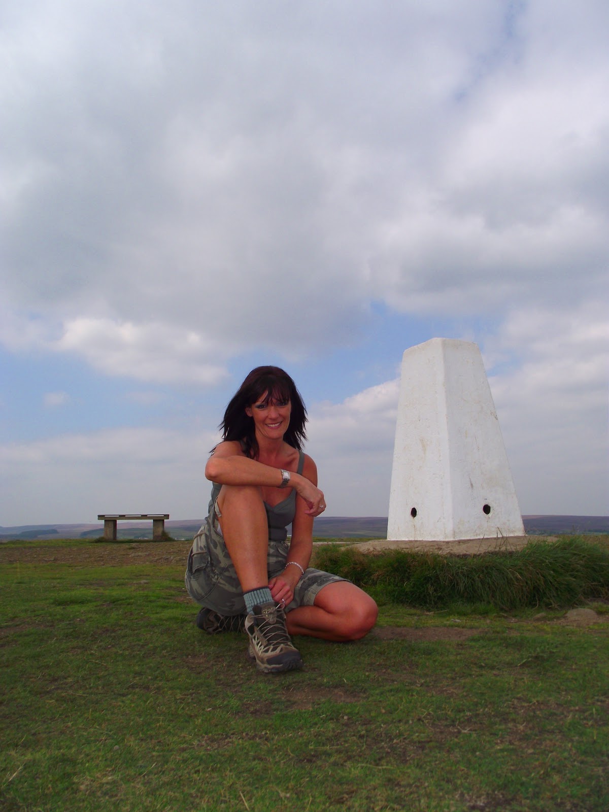

Jim, what you say is true for the trig pillars with their cast bronze grooves. In fact the Ordnance Survey used to 'maintain' the published co-ordinates of each pillar by checking whether the pillar top had moved horizontally relative to the bolt down at the base. There is no 'centre point' at the top, only the radial grooves.
The bubble and stem is useful though when centring over a centre punch mark in steel or a stud in concrete - less effort than trying to scribe out the radials.
Here's a pillar in good condition!
Posted : December 8, 2013 3:27 am
