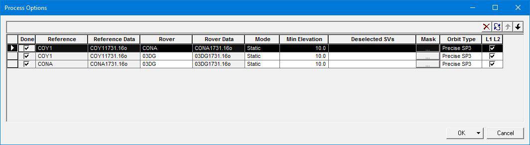

Jim Frame, post: 385005, member: 10 wrote: Those are the basic features I like to see, but in nosing around GNSS Solutions this morning, I didn't find them. I thought they were in there, though -- I'm pretty sure they were in Ashtech Solutions, the predecessor product -- so maybe I'm just not looking in the right places.
According to the User's Manual, those features ought to be present in the Project>Process Options dialog box.

I see the SV on/off control, but without being able to see the noise levels of the SVs in the solution, messing with SVs is kind of flying blind. In TGO/TBC you can see graphically how the well the integer ambiguity determination fits the vector data, so noisy SV data is readily identified. The mask control is obvious, but I don't see any time windowing control.

Jim Frame, post: 385013, member: 10 wrote: I see the SV on/off control, but without being able to see the noise levels of the SVs in the solution, messing with SVs is kind of flying blind.
If I'm understanding the manual correctly, the View>As Workbook option allows you to open several displays at the same time, which I presume are interactive in the editing process.
