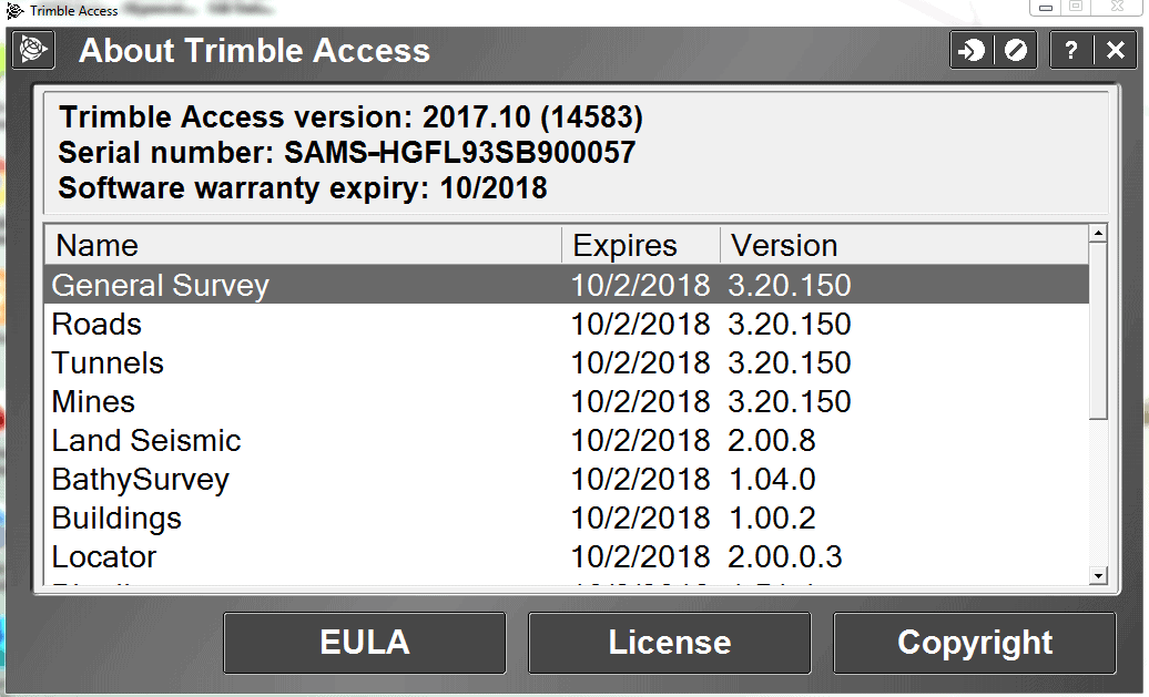

When i used Trimble SX 10 equiqment. An error : " Job exceeds 52 points ". So, Why it can only measure 52 points per a job ?

Are you running Access in demo mode? Are you running version 2017.10?

Access is not licensed properly. What device is it running on?

Access is running as an emulator. What type of collector do you have it running on? If the collector is properly licensed, you can download and run Trimble Installation Manager and it should correct any licensing issues.

Even if you install an emulator, you have to do it through TIM and provide the machine's ID... which leads me to think that it is an emulator, not a licensed copy.

Can you go to the about screen and send me your serial number for Access?

We bought a SX10 equipment unit. They provided equipments including Trimble SX 10 ( full) + controller ( Trimble tablet PC which intergrated TIM, so, we had just updated Access .) I think it licensed properly.

Thank you , guys. The problem is solved.You are right . On my laptop just had been licensed for emulator. And my tablet is licensed for full version.
