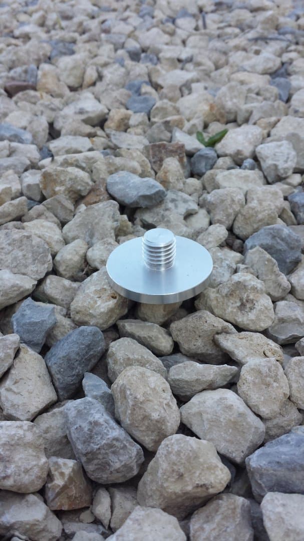

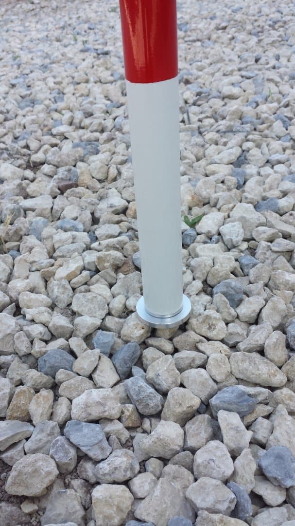

I was working on some basic grade work and got very frustrated with the pointed end on the prism pole and made a flat bottom insert for the pole. I have no idea if these are even available, or if anyone but me would see a benefit to using one?
The insert is designed to simply thread into the socket where the point goes. Nothing too fancy. Was going to make a bigger one but figured it might be more of a pain at times. Might do a bigger one just to see how I like it.

Seco makes this one. The shoe fits over the point in a way that keeps the the H.I, the same. Pretty handy to be able to switch from regular point for control to topo shoe with out worrying about H.I. issues.

Hmm. I have a topo foot for my prism poles that is the same height as the pointed foot. I've had it for at least twenty years. It's really not a problem to interchange the topo foot and pointed foot, putting the unused one in an inside pocket of the vest. The topo foot is basically just a piece of aluminum round stock the same nominal diameter as the prism pole and with a 5/8 x 11 threaded hole to allow it to screw onto the pole.

This is the variety I use. It sounds like what Kent described.

The iron one I purchased some time ago looks more like the one in the Jim Frame pic with the large flat plug on the end except it screws on to replace the point like the one in the Mark Mayer pic.
The 2meter poles that came with my GPS equipment have a plastic cover that screws on over the point and when not in use screws under the level bubble.
