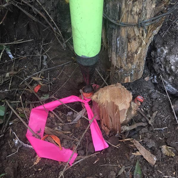

I went out for half a day today to continue the work on a survey of a ranch which is a remainder of a couple of original land grants made by the State of Texas at different times in the middle 19th and in the early 20th centuries. Being a remainder, part of the exercise is locating the boundaries of the pieces conveyed out of the original grants, one of which was a 19.8 acre tract conveyed in 1956 to a development company using a metes and bounds description evidently based upon a contemporaneous survey.
The 5/8" Iron Rod in the photo below is evidently what in 1956 was described as the "iron stake" marking the Point of Beginning in the deed to the 19.8 acres. The metes and bounds description makes no reference to cedar post and wire pasture fences, but judging by other evidence, they probably were in place then and in fact were the basis by which the shape and location of the 19.8 acres were determined. That is, the 1956 surveyor just ran lines approximately parallel with the average lines of the existing pasture fence and what was within those lines was what was conveyed, with no mention of the fence.
A common practice by surveyors at one time was to drive boundary markers as close as possible to existing fence posts and this was fairly clearly what was done at the corner below. Fortunately, the fence old post and wire fence is no longer maintained and it was light work to just saw through the remaining 2 inches of the post diameter below ground to make the actual corner marker much easier to find and tie. I consider leaving existing markers in a condition that they are easier to find and more likely to be stable an essential part of boundary maintenance.
