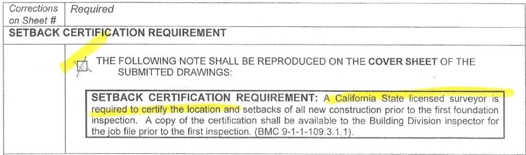

A couple of weeks ago I did two surveys in Burbank. Both of them were to satisfy a 2004 ordinance the city passed regarding the possibility that a licensed land surveyor may need to be retained to certify to the setbacks of existing improvememnts prior to the first inspection of the city inspector for planned additions.
The reason that the city passed this ordinance is that folks would submit plans into plan check, pay the fees, walk out with a permit and have the contractor start work. However, the plan check people would not inform the homeowner that when the city inspector arrived on site he would want to have a certification regarding the form placement.
It was at those times I would get a frantic call because there was not any survey and the inspector would not allow concrete to be poured until a surveyor was involved and certified the forms.
The city now requires this note to be placed on all new plans submitted to the city for a building permit application..

Chris is speaking to the wrong person. The reason that note is on the plans
now is that plan check personnel would never inform a person getting a permit that a
setback survey was needed after the inspector arrived on the site *IF* the person did not have a current survey.. Many people complained about the surprise delay and additional cost mainly for the reason that they felt that the city should make
anyone who applies for a permit aware of what the inspector will need, hence
the note.
If the inspector does not accept my survey I will contact his boss and get
that all straightened out, but there is no need for me to come on site and measure what I have already measured. As long as Chris follows my stakes and shows the inspector the survey you wont have a problem.

To put this to rest once and for all, I just got off the phone with Rick
XXXXXXXXX who is the Building Inspector Manager
for the City of Burbank and he affirmed what I have been telling you.
He told me that if there is an existing survey on site, signed and sealed by
a Licensed Land Surveyor and if the features or monuments that are shown on the survey have not been disturbed and if the contractor does use the set back monuments
to place his forms, then there is no need to have me come back on site to do
a certification for one that already exists as long as a copy of the survey is furnished to the city inspector.
