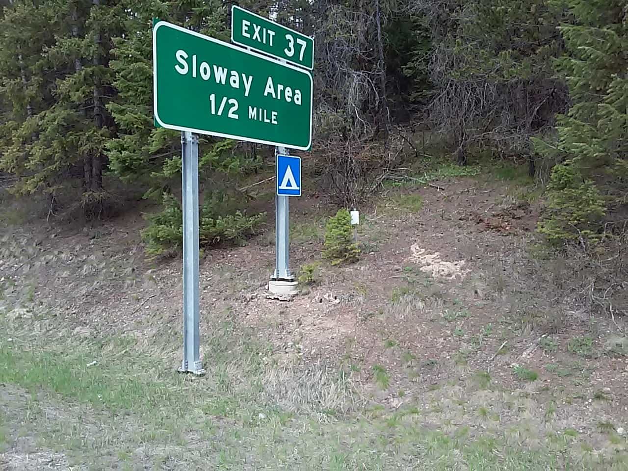

The picture is basically from due south. The mark is in front of the witness post and slightly to the right of the small evergreen-
if you were to submit a recovery on this point, would you classify it as "Suitable for GPS"?

I have done 2hr static on points like that with a 12ft or 16ft pole and a southern exposure with good results.

Well, you can probably get a solution, but it doesn't meet the 15 degree horizon criterion by a long shot. The accuracy of any solution may be seriously affected by lack of signals from a large sector of the compass and possible multipath off the trees and hillside. The sign would be a minor issue but probably wouldn't add a lot of multipath since the mark is almost in line with it. It might be possible to get the antenna above it.
I'd check "don't know", which usually does not add a suitability line or change any prior one on the data sheet, and comment that "GPS observation possible but sky to north largely obscured by trees and hill." The proximity to the sign is already mentioned in the description.
https://www.ngs.noaa.gov/cgi-bin/ds_mark.prl?PidBox=su0823
If your experience is that you've had problems with similar situations, then check "No."
Posted : April 26, 2017 11:05 am

gschrock, post: 425522, member: 556 wrote: Perhaps "suitable for GNSS" but maybe not GPS-only.
Good field practices (mask, evaluation of prelim results) could make this a viable GNSS spot.
Might not want to do it with little tiny pole - think fix height rod with extensions- up high, more sky, multipath go bye-bye....
I don't ever put up more than 12 for long burns- hardly do that.
Posted : April 26, 2017 1:40 pm

Bill93 gave you a good answer. I wouldn't consider it to be "suitable for GPS". I don't really think of "suitability" as whether an operator can get a solution on a point. I'd expect it to be something I might set a tripod on and use for a control network.

For the purposes of the NGS recovery note NO!!!!!! (if I could figure out how to make the font bigger I would). A rod, let alone a 12' rod, in not a stable platform for geodetic type work. Besides clear cutting, you need a chop saw to get rid of the big bad multi-path radiator to the south.

The trees look to be around 30 years old. The location might have been suitable for GPS c.1990. Not so much now.
Posted : April 26, 2017 6:27 pm
I go with No.
Sign and trees are a definitely factors even though you can't see their height.
But they do grow, y'know.
Set an eccentric pair and tie into the mark conventionally. If anyone does that anymore.
There were some marks on bridge abutments here that were designated suitable for gps . Yes, they did have clear sky but the set-up difficulty and safety concern were too much.
