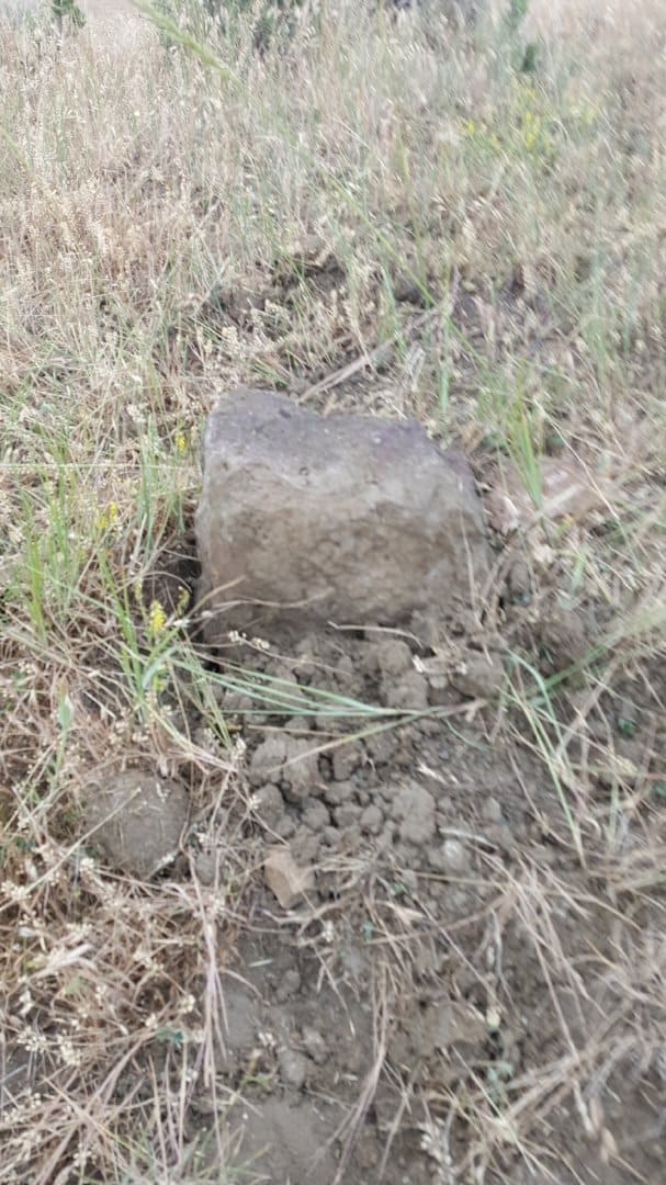

Had the pleasure of looking for monuments in a Section 20. I was able to recover 7 of the 8. The NW corner sits under a stock tank now, lots of broken stones scattered around it:

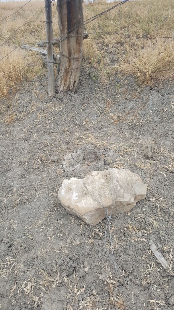

Also the NE corner stone was removed and for a while was used as a tie down 🙁

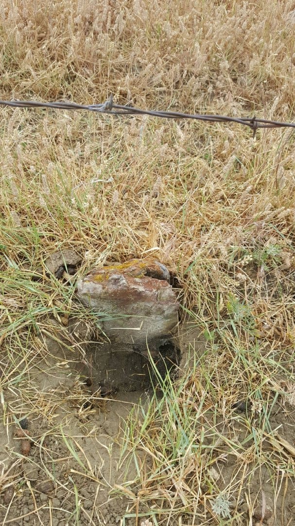

The N1/4 is under an east west fence line, a prairie dog is trying to excavate it so I filled that in, but left it in place as found:

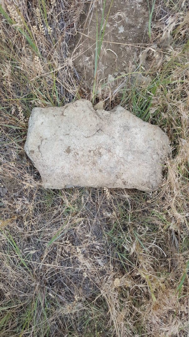

The W1/4 is in nice shape, with a 4 marked on the west face, I stood it up a bit better and left it alone as it is:

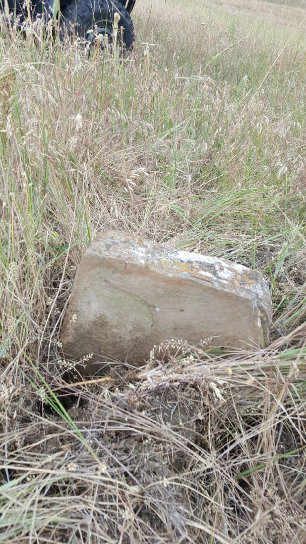

The SE corner is a nice set stone, 4 clear notches on the east face, I couldn't see any on the south face:
