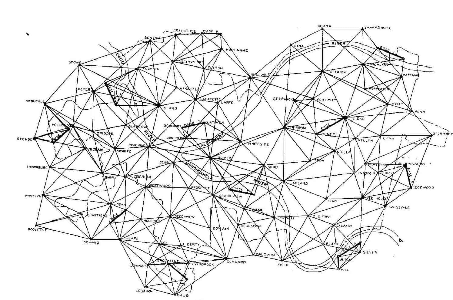

There actually is a use for inverses in an adjustment. I deal with very old control networks occasionally, where none of the data is available (or even still exists). So, the only option is to go out and observe a few points, and then try to "adjust" the network to fit.
I am talking about triangulation networks that were adjusted by hand, and all that remains are coordinates and a map showing the connections between points. I have dealt with several situations like this, on networks from the 20's and 30's, even one from 1890's. The alternative is to just compute a coordinate transformation (using least squares) using the recently observed stations, and then applying the transformation parameters to all of the old coordinates. I usually do the transformation route, but I have messed around with using inverses as observations.

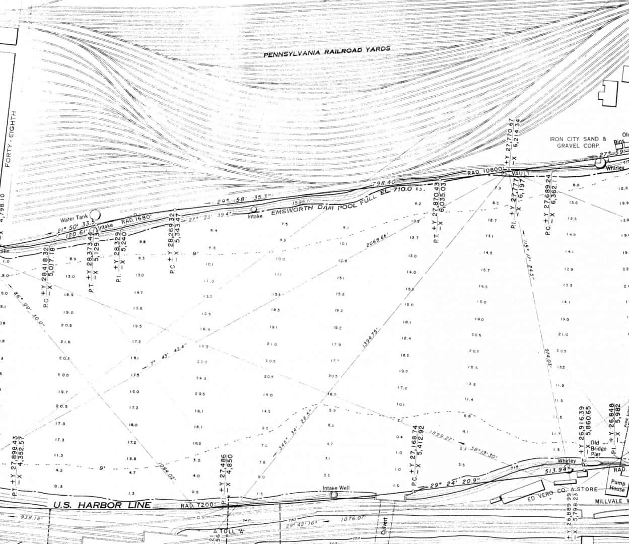

Here is a portion of a network from 1891, the map is dated 1940, but I don't know when the topo was done (by planetable). Note the labels on the lines between control stations (for example VAULT and STORE on opposite sides of the river). They are the inversed azimuth and distance. I am not sure if they taped between stations on the same side of the river, but I doubt it as the notes on the map say it was a triangulation net. In any case, none of the field books with observations have been found, so we don't have the raw angles.

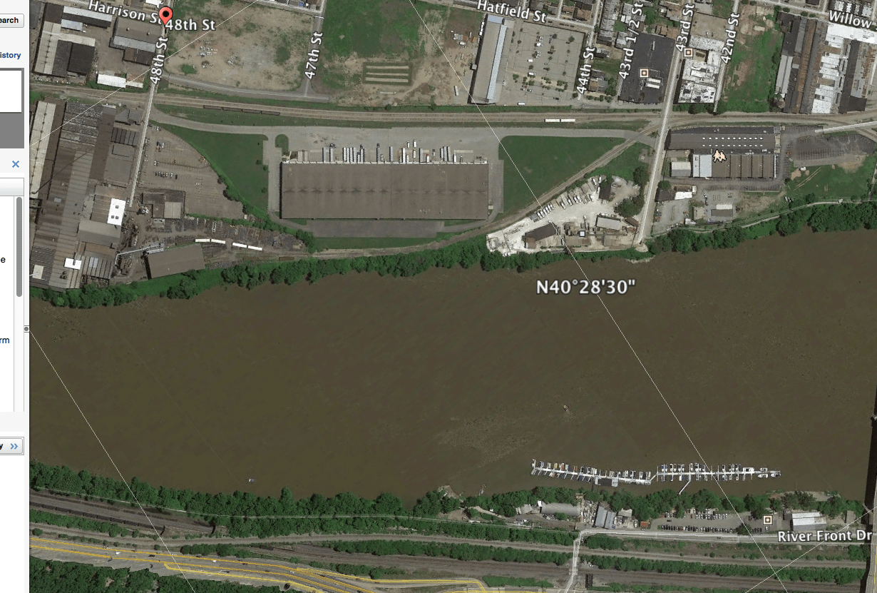

I did recover the ORIGIN of the coordinate system, indirectly. It is gone (wall fell into the river). But I found City survey notes from the 1920's where they tied in the brass plate. I found the nearby City monuments that they used, GPS'd them, and then computed a coordinate for ORIGIN. We have tied quite a few of the old brass plates marking the 1891 network along all three rivers. Needless to say the fit is not very good. I think they probably used a 1' transit for the angles, taped some distances, and never had any other coordinates upriver to adjust to. So it was open-ended triangulation, maybe some length control along the way. As far as I know they only observed polaris at the origin. But, the network is important because it was used to define the harbor lines (tangents and curves) that many property deeds along the river reference. The Harbor Lines were never marked or monumented, but the maps (100's) show the geometry. If one can find a couple of the old monuments in the area, then the HL can be laid out on the ground. The HL system in this area was abrogated 50+ years ago, but still many of the deeds go to it. All of the PT's, PI's, and PC's have coordinates in the HL system

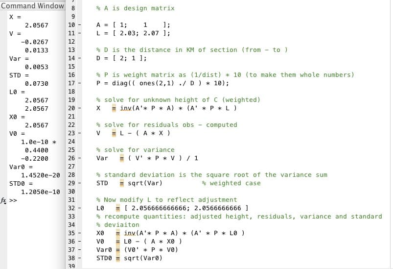

I understood your question to be what happens to an adjustment when one replaces the actual observations with adjusted values. Using the simplest example, leveling to determine one unknown from two knowns, I ran some made up values using Matlab. Unfortunately my computed height was a repeating decimal. I also did not make my updated observations equal.
As can be seen in this simplest case, replacing the observed values with adjusted yields zero (here not quite) residuals. As the residuals are used for the computation of standard deviations no error ellipses can be formed.
I do not use StarNet but the adjustment shown is pretty standard. Improving an adjustment requires new observations, removal of outliers according to rigorous criteria, insuring there are no singularities, recomputing observations (e.g. to account for better models), improving weighting, etc. In Mr. Hamilton's case, he is trying to fit some otherwise unavailable information into the mix. The problem is realistic weighting.
In the image file below, the results are shown on the left, the script file to the right. I forgot to label "L" it is the observation matrix. To over explain, if I ru levels from point A to the unknown and point B to the unknown, I can merely add the height differences to the known heights to calculate two starting values for the unknown. What is the optimal value for the unknown? I added the distances from each known to the unknown (in KM) which I used to provide weights. While I could have done this more efficiently, I hope this is clear.
Hope this contributes,
DMM

I think I found the spot (of the first drawing)...in Pittsburg. How one even finds such old monuments in an urban area after decades of change is pretty amazing.
