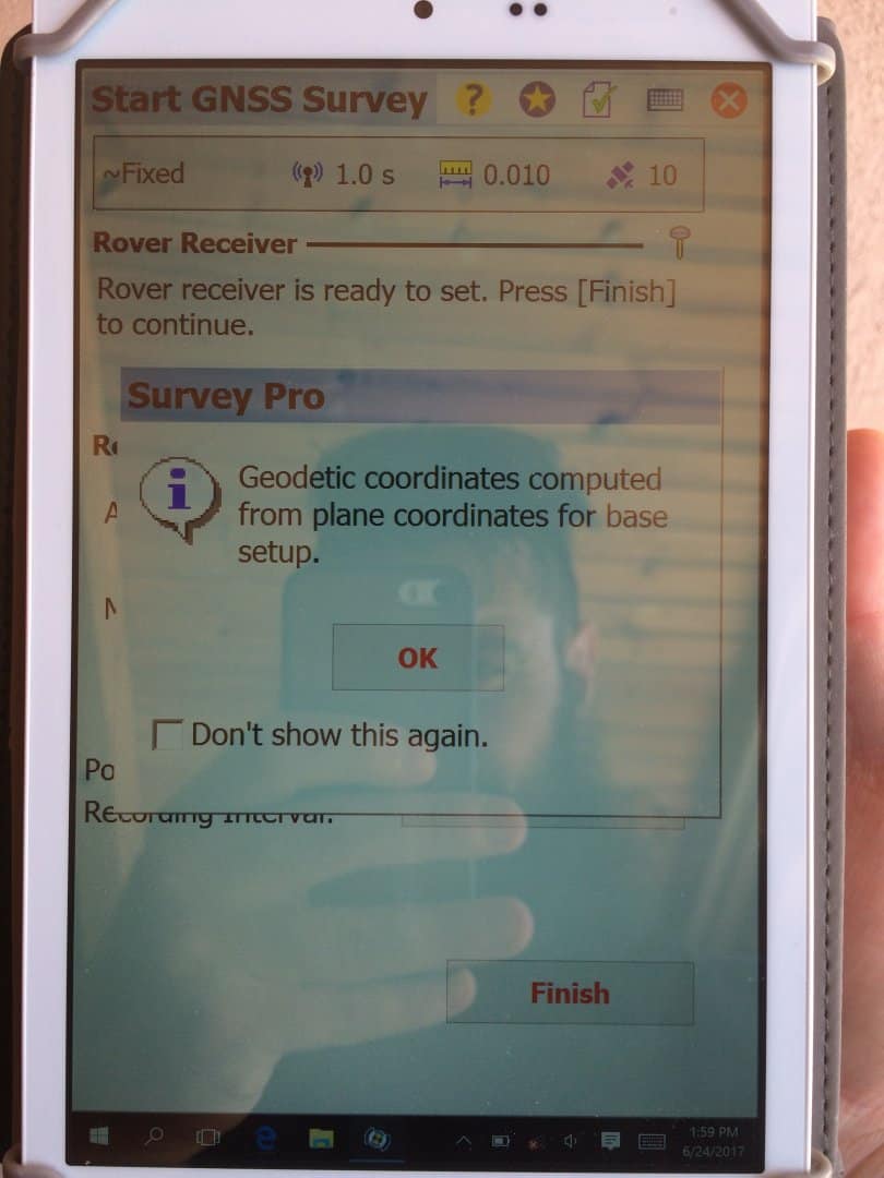

I was doing a base-rover rtk, and set the base unit to a known control point. I selected base is on a known point and punched in the coordinates based on the projection system they were on. I named the point base_1 and then i got the following message and an additional point storted on my database named base_1_GNSS. What does this message tell and what is the purpose of the new point it created

I would guess that base_1 was a manually or through ascii entered point and did not have a LLH associated with it and Survey Pro created a paired point. This is the same way it handles calibrations/localizations. This is speculation because I haven't used a base since before version 5.0 which handled GNSS differently.

I'm guessing that you entered your point in SPC. Since GNSS works in geodetic coordinates, it has to compute lat and long to work off of, based on the SPC that you entered. The new point it created should have identical SPC values as the point you entered.
Also, if you insert a point and then try to use it for a base point for your setup, you will need to go under the geodetic tab and uncheck the box that says "has geodetic", because it will have assigned it the SPC and geodetic coords from the previously stored point. When you change the SPC to the new point, it will not change the lat and long and will give you an error message asking if you want to rectify the coords.

Good Morning. Are you talking Survey Pro or Trimble Access, cause i dont see a geodetic tab and "has geodetic" option. Project is not in US, so not in State plane, but on a Grid Plane nevertheless and coordinates are key-in as grid based on a post-processing that has been previously performed on office that gives the base position.
I even tried to enter location WGS84 format instead of grid when creating the base point, behavior was the same. I also exported the point it creates as a geodetic calculation then imported that point on a new project and same thing once again.
Thing is i'm trying the demo that has 25 point limitation. ! is for the base so actually 24 points on the project. And now i get a base and a point it calculates for the base and it makes experimenting with a project difficult with 23 points, until i get a fully working version.
