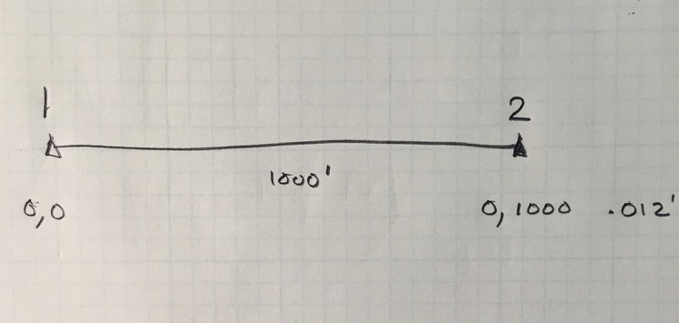

rfc, post: 340226, member: 8882 wrote: Under what circumstances should one use standard errors in the "C" data line? Don't the apriori assumptions for standard errors for the observations "drive the boat" here?
Specify standard errors when you have them. For example, if you have coordinates from a previous adjustment, you can use the standard errors reported in that adjustment.
The a priori errors for coordinates without explicitly stated errors is essentially infinite, i.e. they're free to move as much as they have to. But in some cases the adjustment engine needs some starting values to push against, and that's where free station coordinates are useful.

I think Kent's answer may be closer to getting at the question than Jim's. None of the points have been previously adjusted. They're right out of the raw data.
In the simple example shown...a single distance observed with an instrument whose distance constant is, say .009', and whose PPM is 3.0 would result in a standard error for the observation of .012' (I hope I got that right). The question is, if Star*net is going to use that for the observation, why include the coordinates the DC or software came up with at all, in a data lines that would read:
C 1 0.0 0.0 ! !
C 2 0.0 1000.0 * *
either with or without the standard error for the observation added. Isn't it the same thing?
Posted : October 13, 2015 6:59 am
