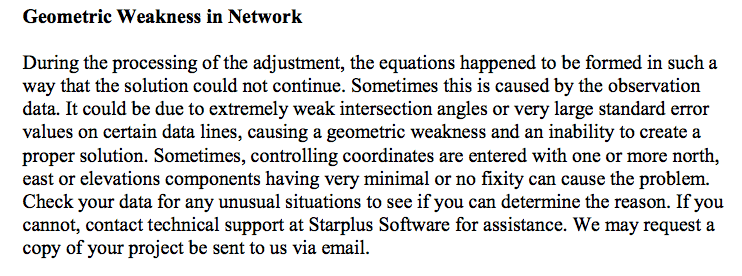

Troubleshooting some very simple triangle/quadrangle traverses for a control network. Star*net is reporting the error "Geometric Weakness found".
The manual contributes this:
Huh? Not much of a clue there. The part I like is: "Check your data for any unusual situations..." Ya, like that describes just about everything I attempt to do lately, it seems like.
Ideas?
