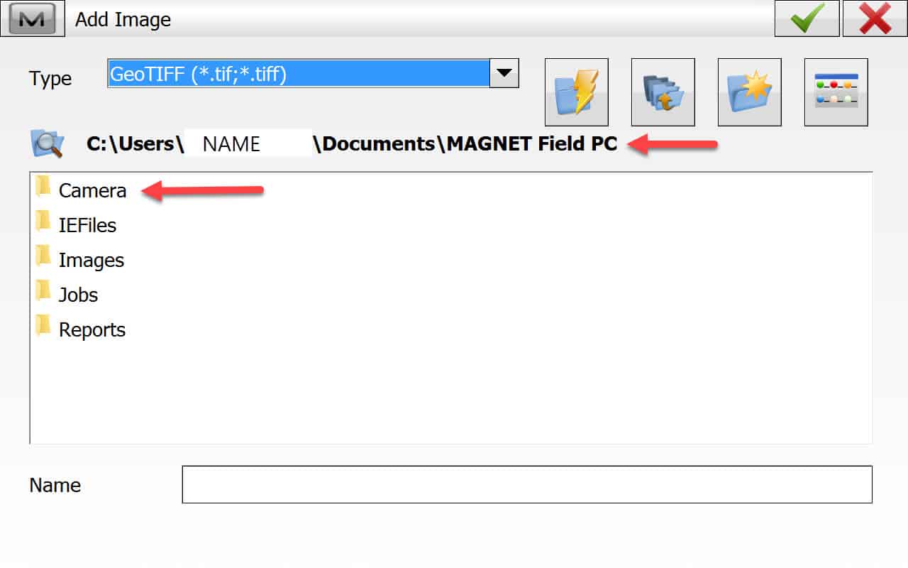

The photos are store under a folder that is the same name as your project file, and a subfolder called photos. Copy the images from that folder.

I've got the directories Backups, Cache, Notes and Vectorbackgrounds.
All are empty. is there a setting in field to give the directory to put the pictures?

I don't know how to change the default.
Look under your users folder as shown below.

Lee,
I have the same directories but the images directory is empty. It (the map itself) does show the date my last picture was taken. This is very strange. If i search for jpg or tiff on the tablet i have no results. It looks like a setting which i don't find.

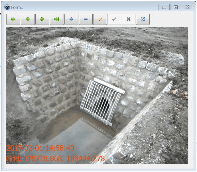

FWIW, the mjf file appears to be a SQLite database. It contains a table named tblImageData, and it looks like beukie's file contains 262 photos in that table as blob data. But I'm not smart enough to be able to extract them as image files. 🙁

Indeed SQLite ... did some Quick & Dirty RAD programming with Lazarus.
The pictures are in there, need only a way to save them back to disk.

I don't know anything about databases or programming but i can say that this one of the pictures taken.
If you're smart enough to extract them or provide me with a little software i can send a nice case of beer (or 2) your way.:-)

Routine to view images from the 16059.mjf file (zip above) and save to disk ... if the SQLite drivers will work.
Place all files in C:Temp
Run the exe file
Doubleclick the image to save them to disk
Christof.

Jim Frame, post: 412482, member: 10 wrote: I'm impressed! How did you determine the image file format? And is each image file simply the data between quotation marks?
Jim,
with the tools I used I did not need to, I only had to specify the file format for saving the image.
You did half the work, indicated the file as a SQLite database and give allready the right table to look for.
I guess you also used SQLiteManager?
https://sqlitestudio.pl/index.rvt
But there under the Data tab is no preview for Images.
So I used Lazarus, an Open Source Delphi clone - Delphi is like Visual Basic but with the Pascal language. That doesn't realy matter, most of these program languages have a lot of components (building blocks)
I used the database components to connect to the job file and made an active connection with the table with the images.
I added a navigator and an Image component. These are realy powerfull, no need to specify the type, the component is smart enough to figure that out and knows how to load, display and SafeToFile.
In fact, besides setting properties for the components, the only code I wrote are the lines in blue to extract the filename from the reccordnr.
