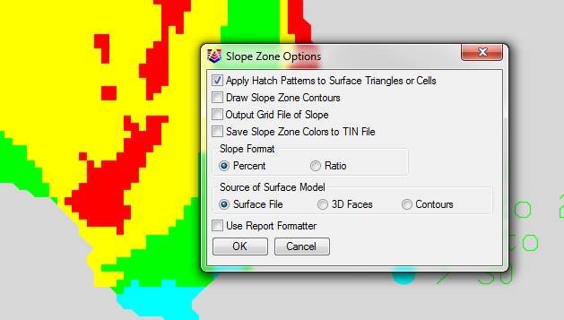

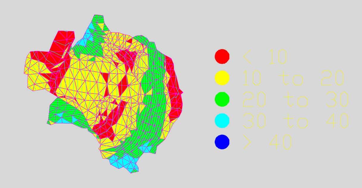

Looks like your version of software may not have the options necessary to generate the analysis you are looking for. These may be options that are included in the civil module.
This was created using the latest version of Carlson Civil/Survey on Autocad.
EDIT: Looking even closer, it looks like you do have the option to hatch grid cells (it's just at the command line instead of in the options window.). I have no doubt that the folks at Carlson will be willing to walk you through this task today (for free). Your problem may be with how the slopes are being entered/expected 2:1 vs 1:2. I would convert your slopes to percent and try and run the routine through that way.

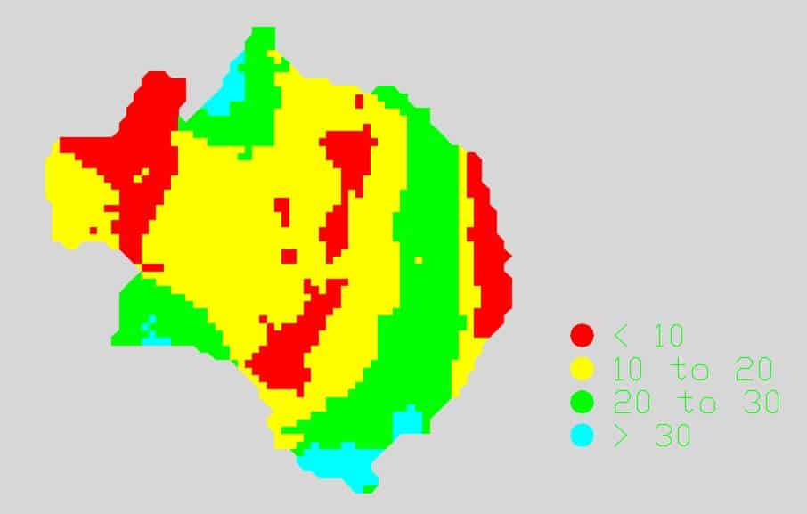

Imaudigger's results are exactly what I need.

If you'd care to send me your data and preferred settings, I'll take a look (no charge).

Several different ways to skin a cat. The Carlson routine works (evidence by my screen shot), it just takes some experience doing this type of work using Carlson.

Ladd is a win!
It appears my software is likely out of date, and I think MS updates may have damaged or disabled some of the routines.
I will update to Survey 2014 and see if that fixes the my problem, or come to find out that it is all me.
