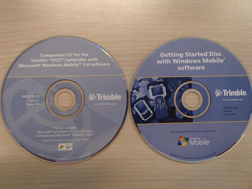

These are the two CDRoms I have,
Only Handbook software and ActiveSync and Mediacenter
These are no recovery disks for the OS.
I guess a Trimble dealer is your only option ...
